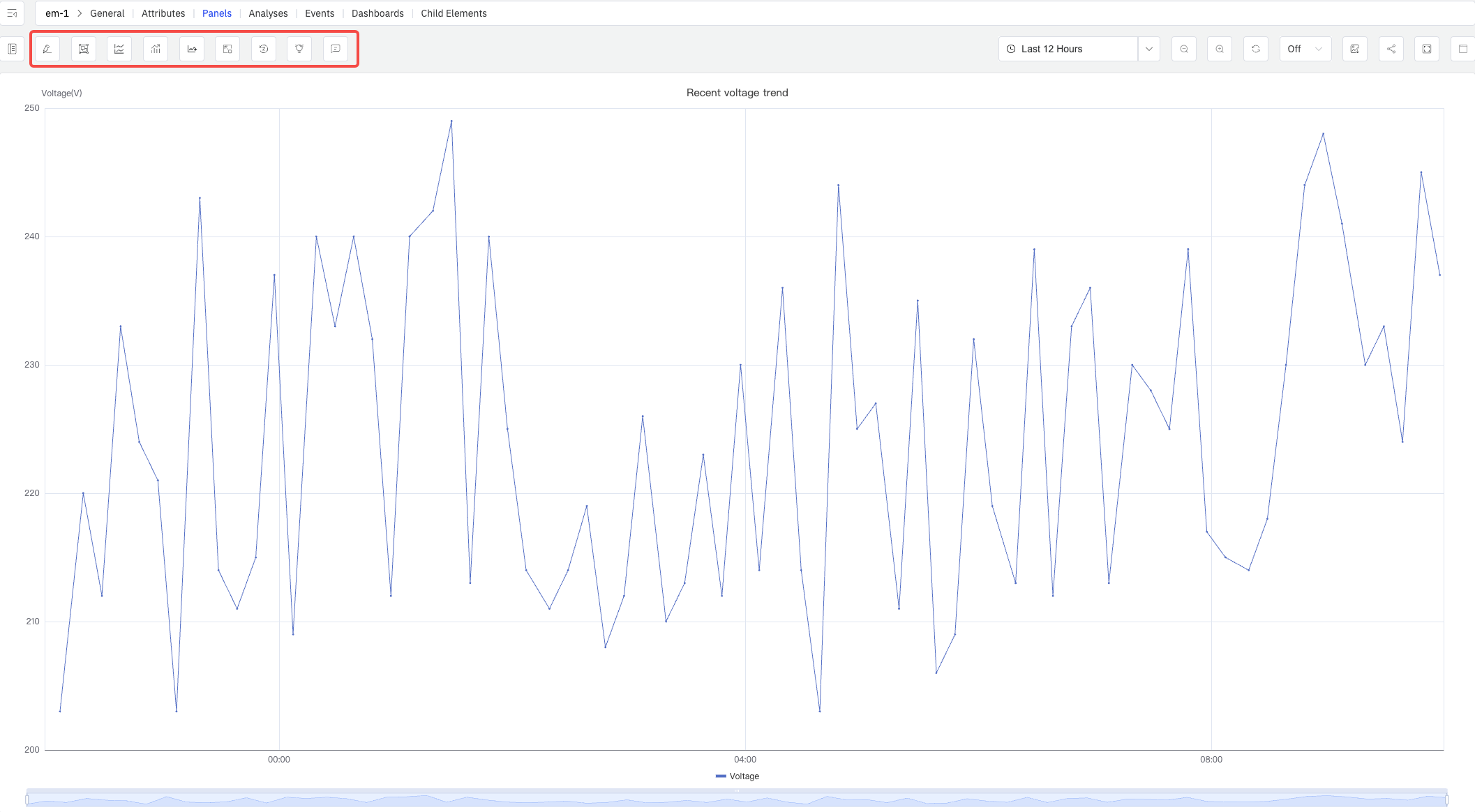

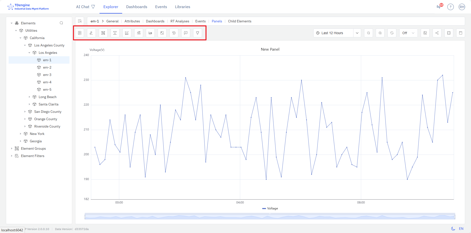

View Mode Toolbar
The Trend Chart provides a set of chart-specific toolbar buttons in view mode (highlighted in the red box below) for quick analysis:
| Control | Description |
| Edit | Enter the edit page for the current panel |
| Add to Group | Add the current panel to a custom group for quick access |
| Downsampling | Enable or disable downsampling |
| Multi-Swimlane | Display each metric in its own horizontal lane instead of sharing a single Y axis |
| Window Analysis | Run a window analysis on the current time-series data. Supported types include sliding, state, event, anomaly detection, session, and count windows |
| Forecast | Run AI forecasting for the metrics on the chart and extend it with predicted values beyond the time range |
| Imputation | Enter imputation mode — drag across a data gap on the chart and the system fills it using AI-based trend estimation |
| Reset Imputation | Remove all imputation results currently applied to the chart |
| Show Annotations | Display annotation information for the current chart on the right side of the page |
| AI Interpretation | Run AI panel interpretation or general analysis on the current chart, output a text analysis report, and optionally add and execute custom AI Functions |

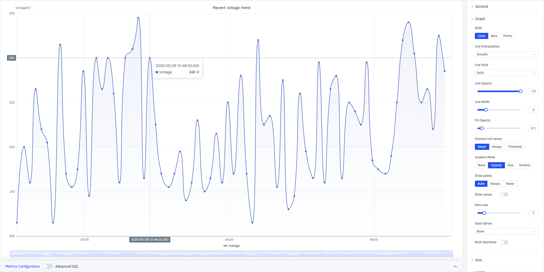

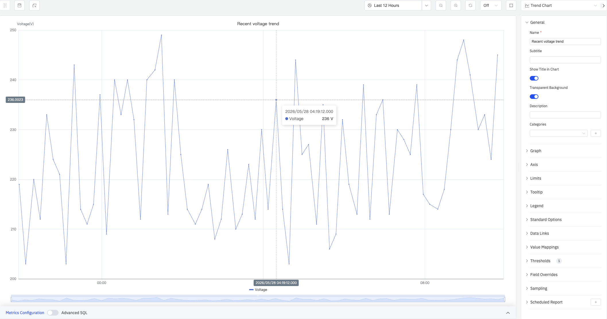

Graph Settings

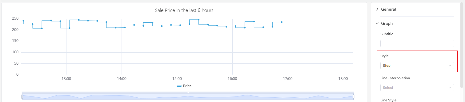

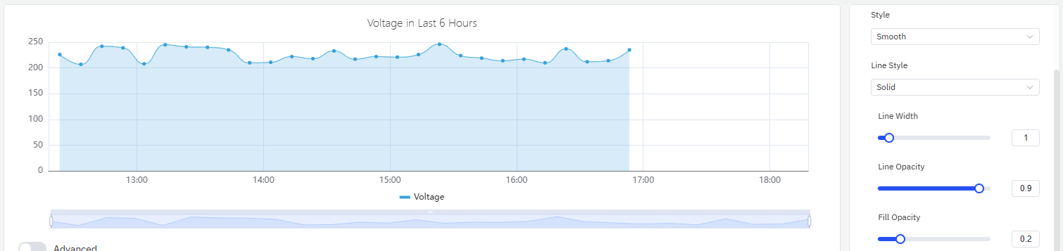

The Graph section determines rendering style and layout:
| Setting | Description |
| Style | Rendering mode: Lines, Bars, or Points |
| Line Interpolation | How data points are connected in line mode: Linear, Smooth, Step Start, Step Middle, Step End |
| Line Style | Stroke pattern: Solid, Dashed, or Dotted |
| Line Opacity | Line opacity (0–1) |
| Line Width | Stroke thickness (0–10) |
| Fill Opacity | Opacity of the area fill below the series (0–1, 0 = no fill) |
| Connect null values | How nulls are handled: Never, Always, or Threshold |
| Gradient Mode | Color gradient: None, Opacity, Hue, or Scheme |
| Show points | Point visibility: Auto, Always, or Never |
| Show values | Toggle to display value labels on the chart |
| Point size | Pixel size of data-point markers (1–40) |

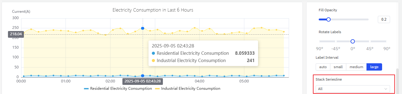

| Stack Series | Stacking mode: None, Same Sign, All, Positive Only, Negative Only |
| Multi-Swimlane | Display each series in its own horizontal lane with an independent Y axis |

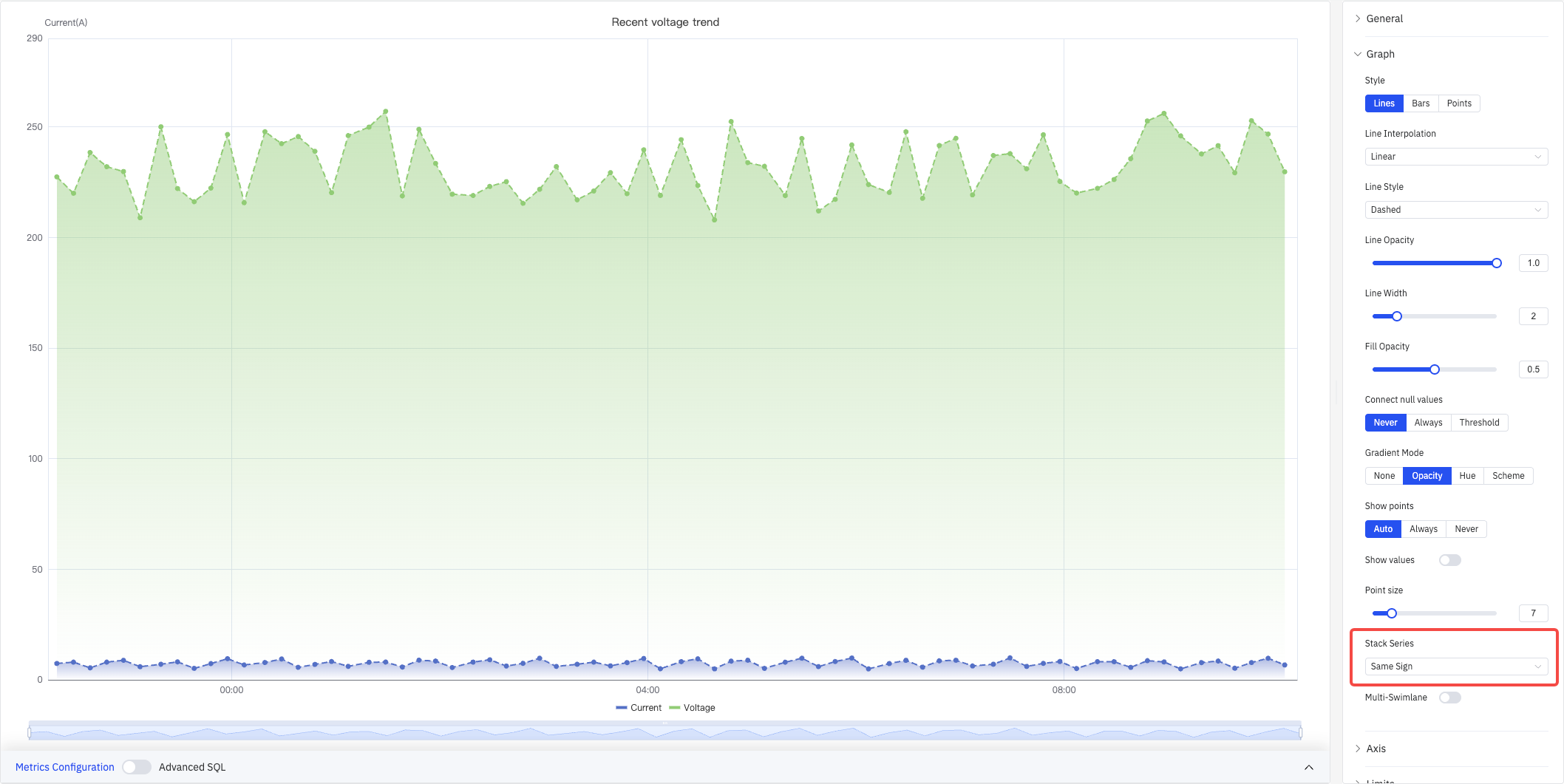

Stack Series
When Stack Series is enabled, multiple series accumulate vertically — useful for showing how components contribute to a total:

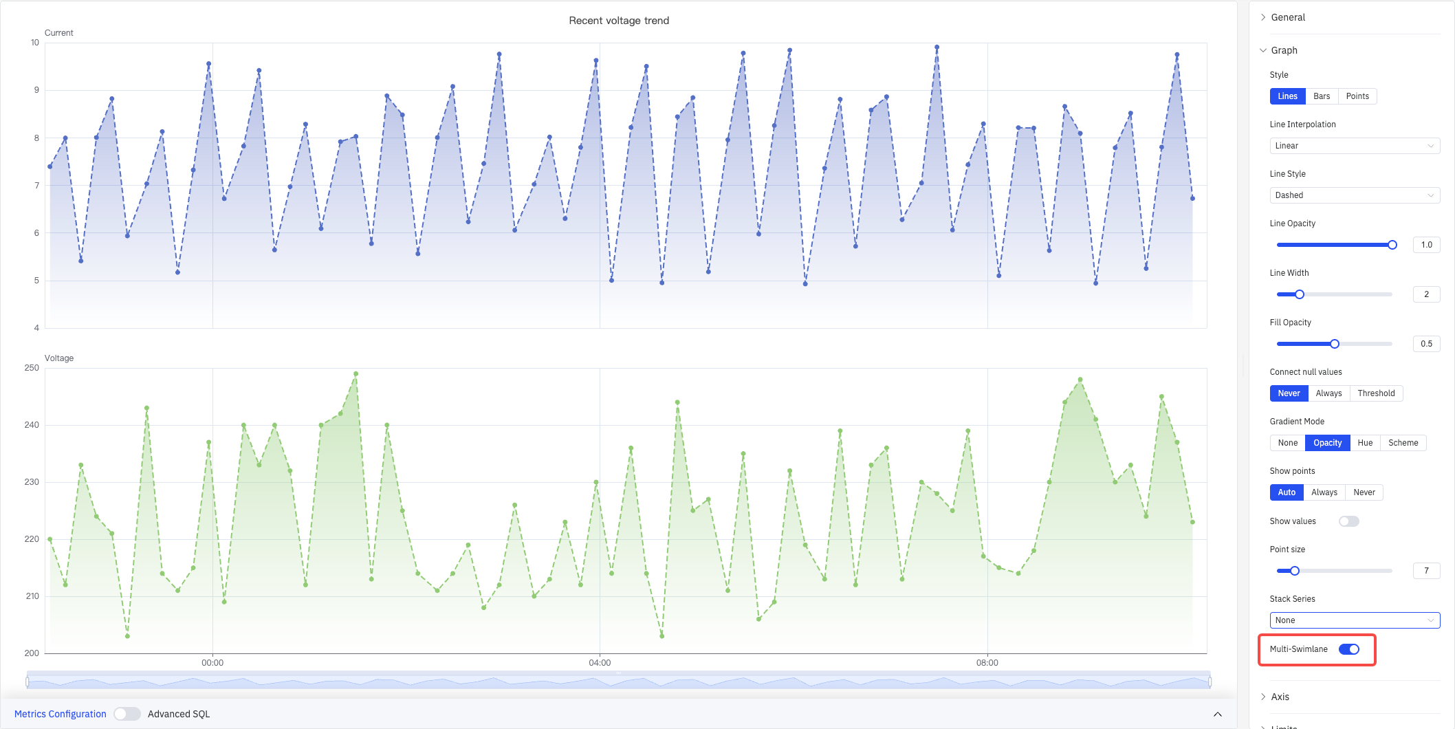

Multi-Swimlane
When Multi-Swimlane is enabled, each metric gets its own horizontal lane with an independent Y-axis scale, preventing small signals from being compressed when ranges differ:

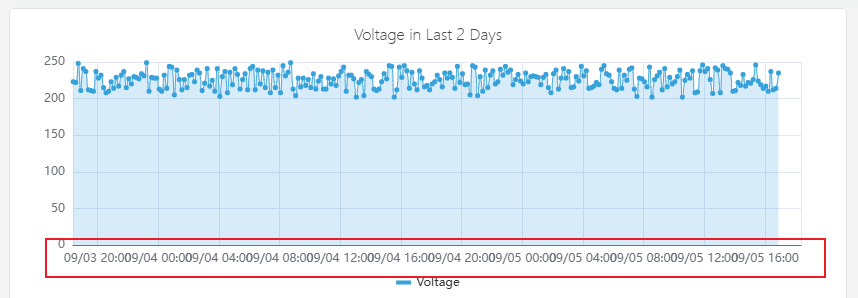

| X Axis | Show or Hidden |
| X Axis Time Format | Display format for X-axis timestamps (e.g., YYYY-MM-DD HH:mm) |

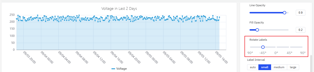

| Rotate Labels | Rotation angle for X-axis labels (-90° to +90°, in 45° steps) |

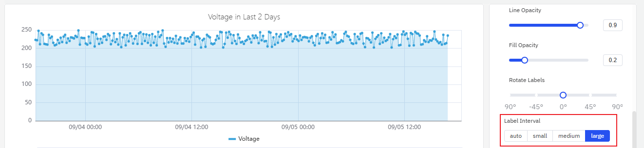

| Label Interval | Label density: auto, small, medium, large |

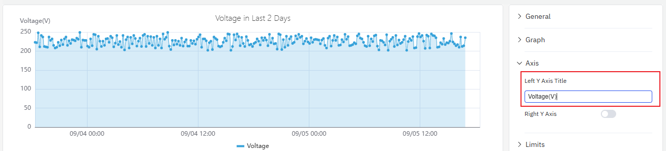

| Left Y Axis Title | Label text for the left Y axis |
| Value Range | Min and max for the left Y axis (leave blank to auto-scale) |

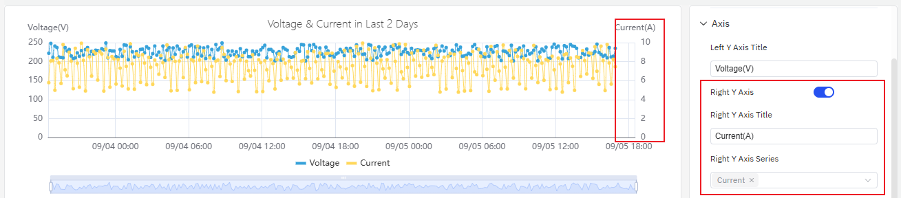

| Right Y Axis | Enable a secondary Y axis on the right (toggle) |
| Right Y Axis Title | Label text for the right Y axis (available when enabled) |
| Right Y Axis Series | Select which series are bound to the right Y axis (available when enabled) |
| Value Range (Right) | Min and max for the right Y axis (available when enabled) |
When two metrics differ by orders of magnitude (e.g., voltage 200+ V vs. current 4–10 A), enabling the right Y axis and binding the smaller signal to it lets both curves display clearly.

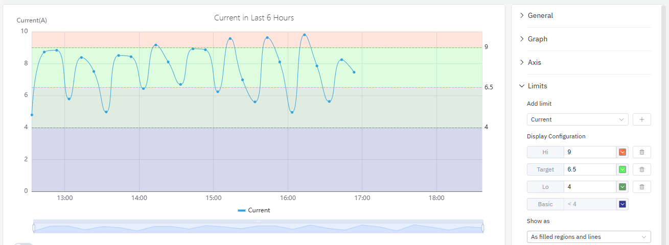

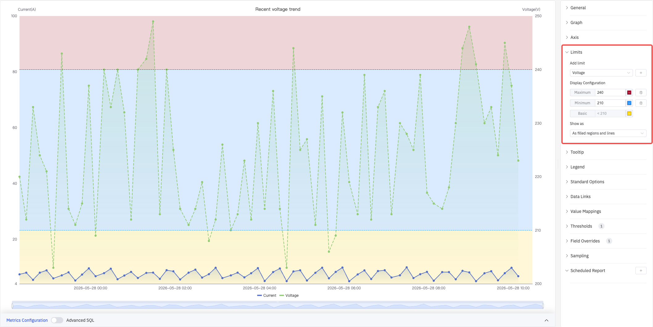

Limits
Limits overlay horizontal reference lines or shaded regions on the chart so that out-of-range conditions are immediately visible:
Select a metric source from the Add limit dropdown, then add predefined limit types: Maximum, HiHi, Hi, Target, Lo, LoLo, Minimum. Each limit supports a custom value and color.
| Add limit | Select the metric source, then choose a limit type from the dropdown (can be added multiple times) |
| Show as | How limits are rendered: As lines, As filled regions, As filled regions and lines |

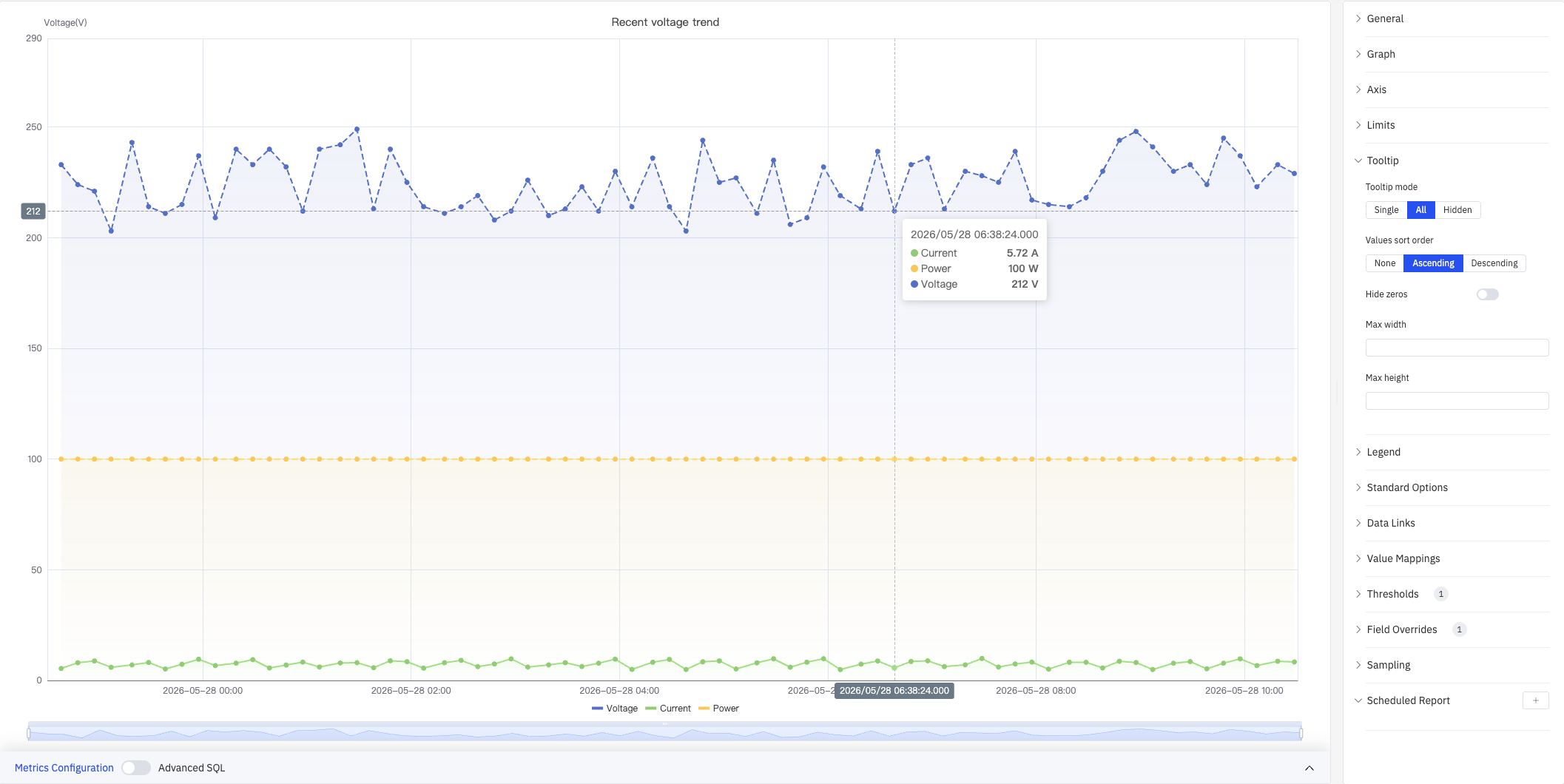

Tooltip
Tooltip settings control what is shown on hover:
| Tooltip mode | Hover display mode: Single, All, or Hidden |
| Values sort order | Sort order in the tooltip: None, Ascending, Descending |
| Hide zeros | Whether to hide values equal to 0 in the tooltip (toggle) |
| Max width | Maximum tooltip width in pixels |
| Max height | Maximum tooltip height in pixels |

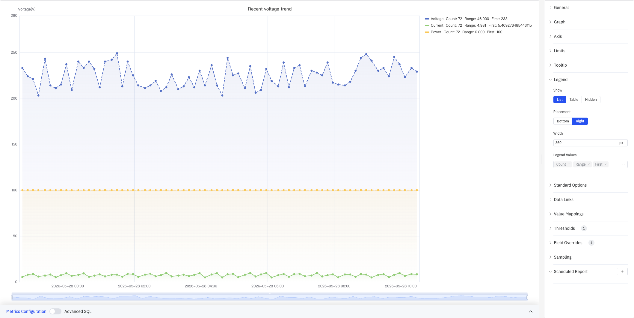

Legend

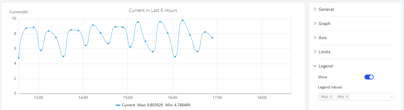

The legend supports list mode and table mode. In table mode, summary statistics (e.g., Count, Range, First) are displayed next to each series name for quick cross-metric comparison:
| Show | Display mode: List, Table, or Hidden |
| Placement | Position: Bottom or Right |
| Width | Legend panel width in pixels (Right placement only) |
| Legend Values | Statistics shown in table mode (multi-select): Max, Min, Mean, Sum, Count, First, Last, Range, etc. |

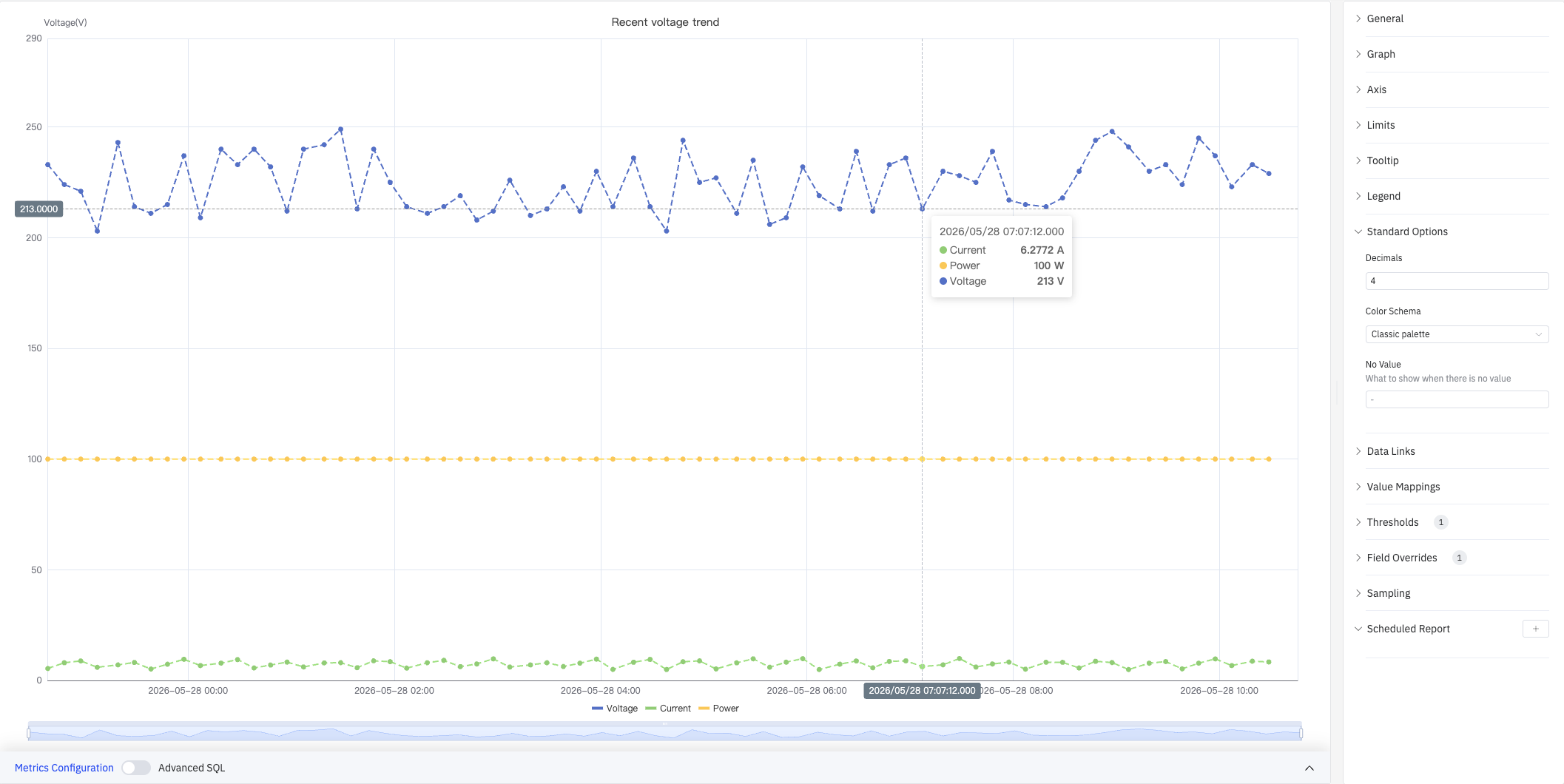

Standard Options
Standard Options provide global display and color settings:
| Decimals | Number of decimal places for value display (leave blank for auto) |
| Color Schema | How series colors are assigned: Single Color, Shades of Color (by series), From thresholds (by value), Classic palette, Classic palette (by series name), Custom palette |
| No Value | Text to display when there is no data (default -) |

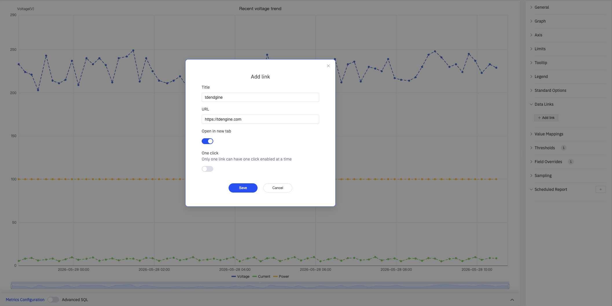

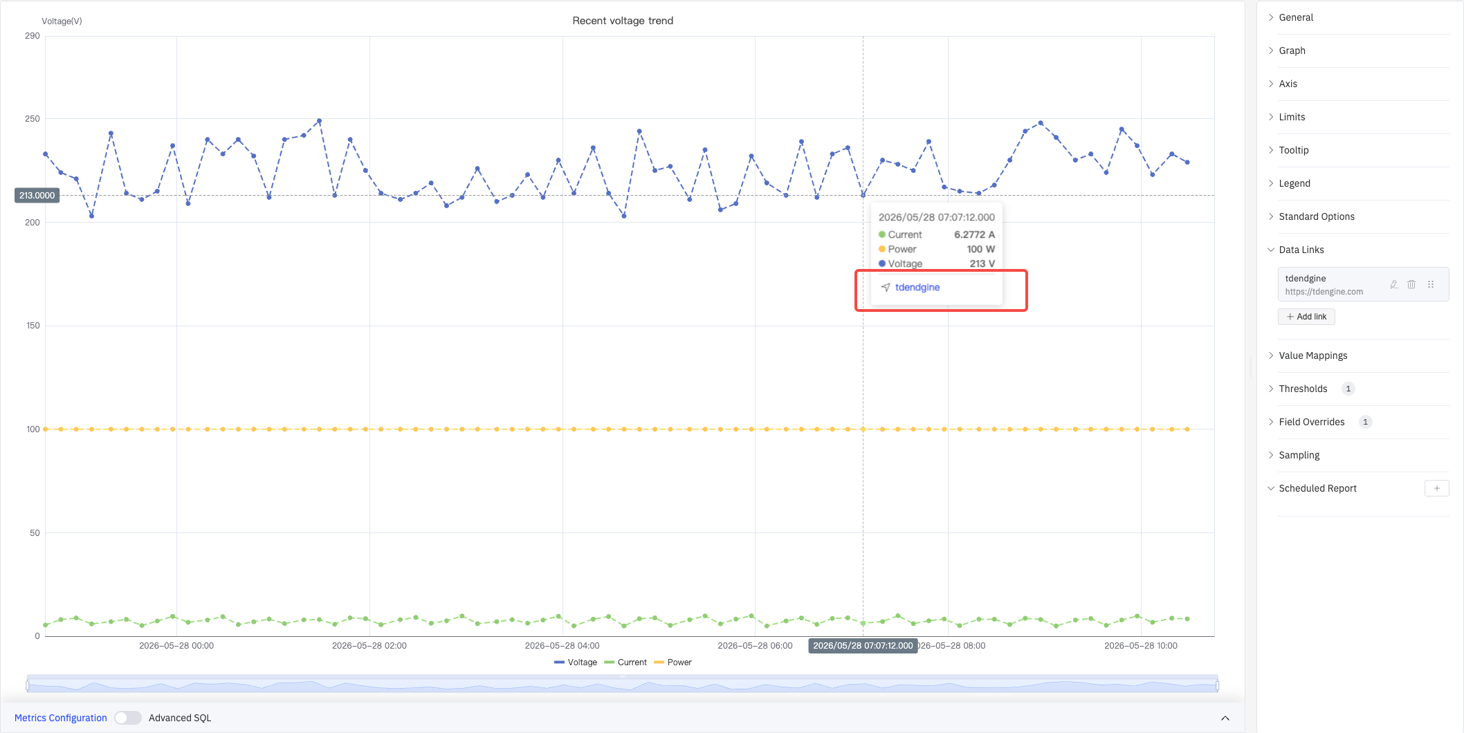

Data Links
Data Links attach clickable URLs to data points. Once configured, a link entry appears at the bottom of the tooltip on hover:
Click + Add link to open the edit dialog:
| Title | Display name for the link |
| URL | Target URL, supports variable interpolation |
| Open in New Tab | Whether to open the link in a new browser tab |
| One-Click | When enabled, clicking a data point immediately navigates (only one link per panel can use this) |

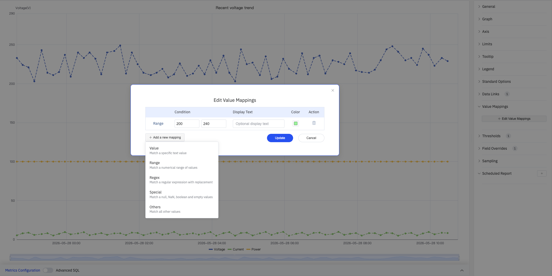

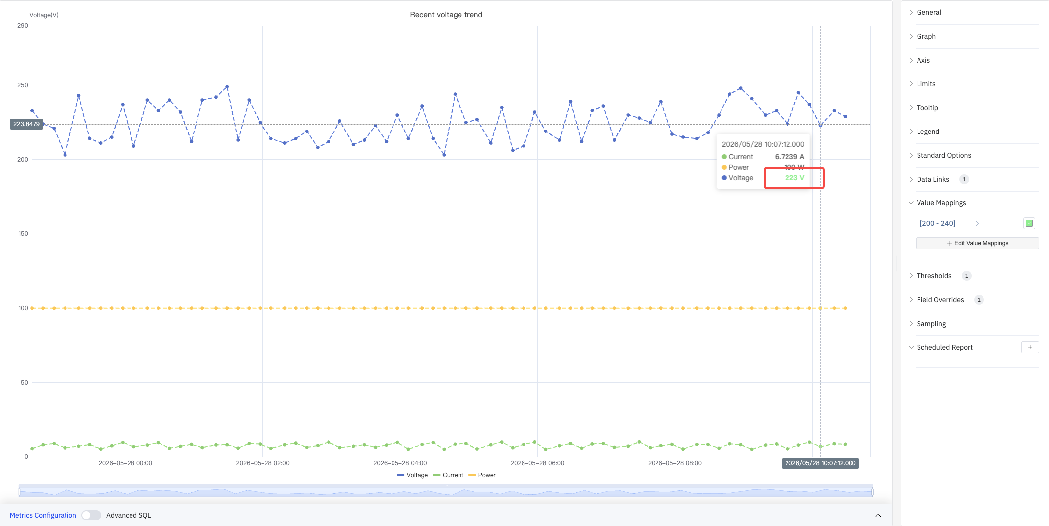

Value Mappings
Value Mappings replace raw data values with custom display text and colors. Once configured, matching values are highlighted in the tooltip with the mapped color:
Click + Edit Value Mappings to open the edit dialog, which supports the following mapping types:
| Mapping Type | Description |
| Value | Exact match on a specific value or text |
| Range | Match a numeric range |
| Regex | Match using a regular expression with replacement |
| Special | Match null, NaN, booleans, empty strings, etc. |
| Others | Match all values not covered by preceding rules |

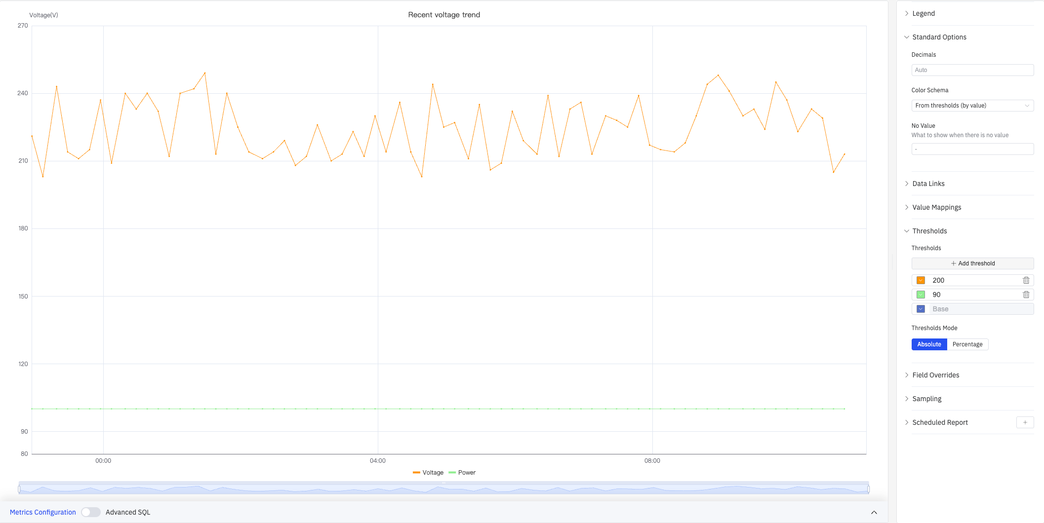

Thresholds
Thresholds dynamically change series color based on data values, highlighting segments that exceed normal operating ranges:
| Thresholds Mode | How threshold values are interpreted: Absolute or Percentage |
| Add threshold | Add a threshold rule consisting of a numeric boundary and a color |
Color thresholds take effect when the Color Schema in Standard Options is set to From thresholds (by value).

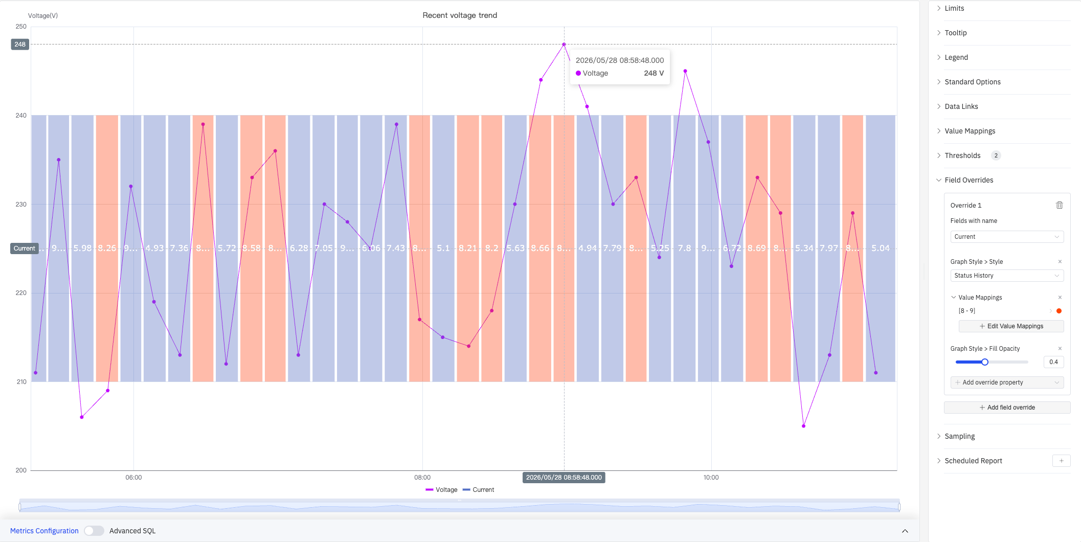

Overrides
Overrides let you apply style settings to individual series, overriding the global graph configuration:
Select a target metric by name (Fields with name), then add properties to override, including: Graph Style > Style, Fill Opacity, Value Mappings, and more.

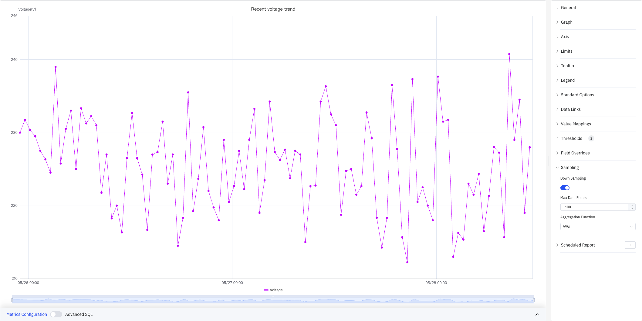

Downsampling
When query results contain too many data points, downsampling reduces the rendering load and improves display performance:
| Down Sampling | Toggle, off by default |
| Max Data Points | Maximum number of data points retained after downsampling |
| Aggregation Function | Aggregation method used when downsampling (e.g., AVG, MAX, MIN) |

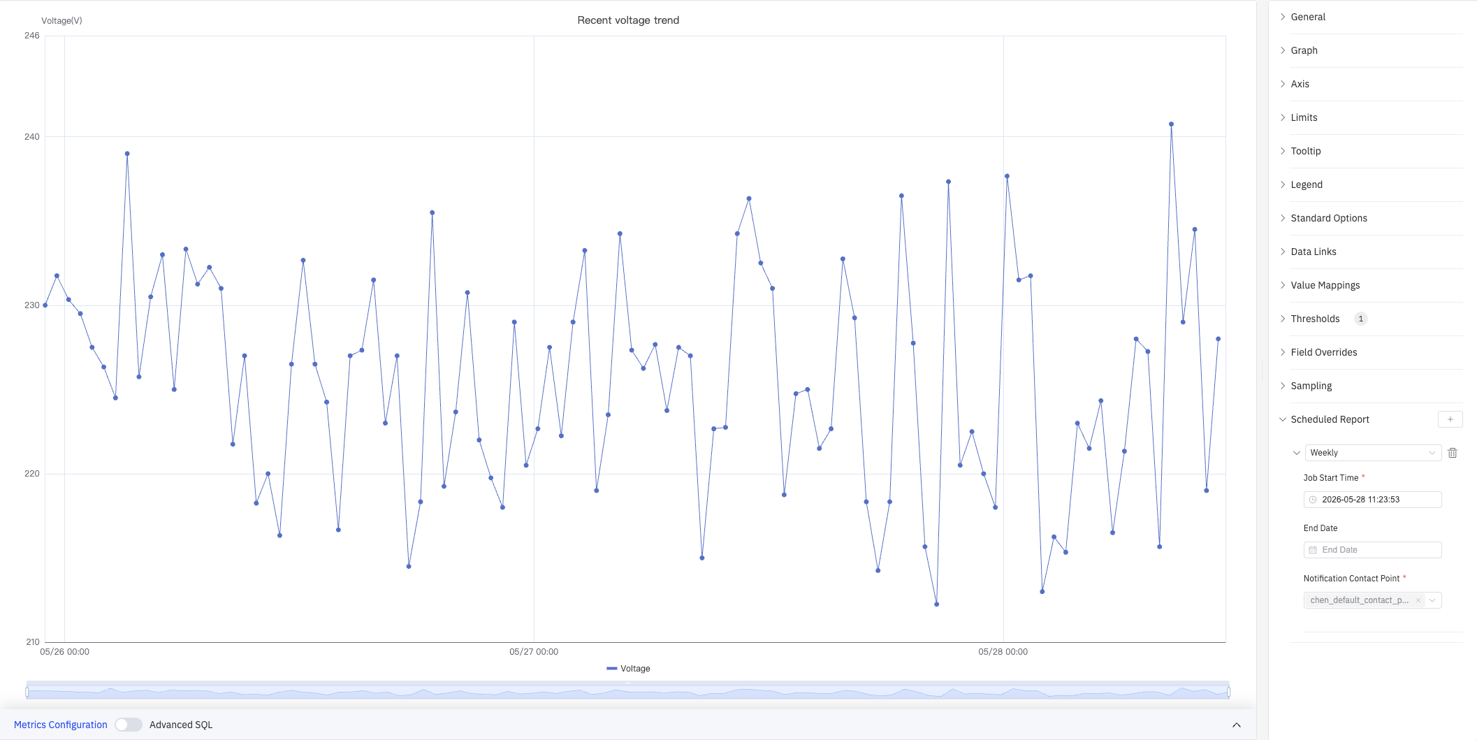

Scheduled Report
Scheduled Reports automatically generate and push panel snapshots at a preset interval:
| Frequency | Send interval: Weekly, Daily, etc. |
| Job Start Time | Date and time of the first execution |
| End Date | When the scheduled task stops (leave blank for no end) |
| Notification Contact Point | The contact point that receives the report |

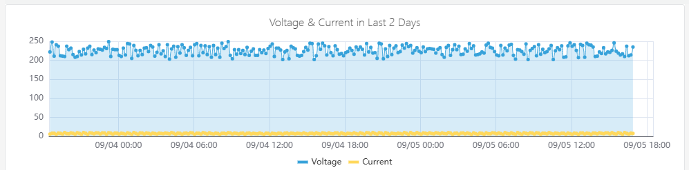

Energy monitoring with stacking. An energy manager needs to see voltage and current together with the total load. Two metrics are added to the same trend chart, Stack Series is set to Same Sign, and Fill Opacity is set to 0.5. The combined area makes total demand variation obvious.
Dual-signal monitoring with different ranges. A process engineer needs to monitor voltage (200+ V) and current (4–10 A) on the same chart. With a shared Y axis the current line appears flat. Enabling the Right Y Axis and binding the current to it makes both curves readable.
Real-time operating-limit monitoring. An operations team monitors whether voltage exceeds the Maximum (240) or falls below the Minimum (210). After adding limits, the exceeding zones are shaded with limit colors (Show as: As filled regions and lines), making out-of-range periods instantly visible.
Mixed-style overrides. A maintenance engineer displays voltage as a line chart and current as a status history color band in the same panel. Using Overrides, the Current metric is set to Style = Status History, producing a hybrid view that shows continuous values alongside discrete intervals.
