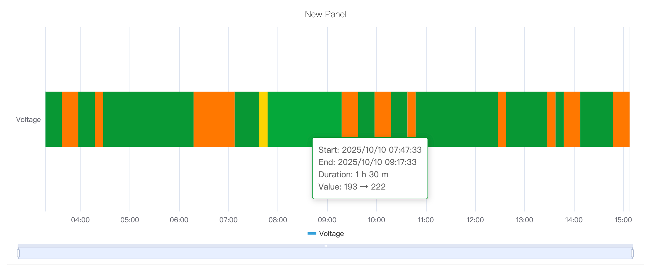

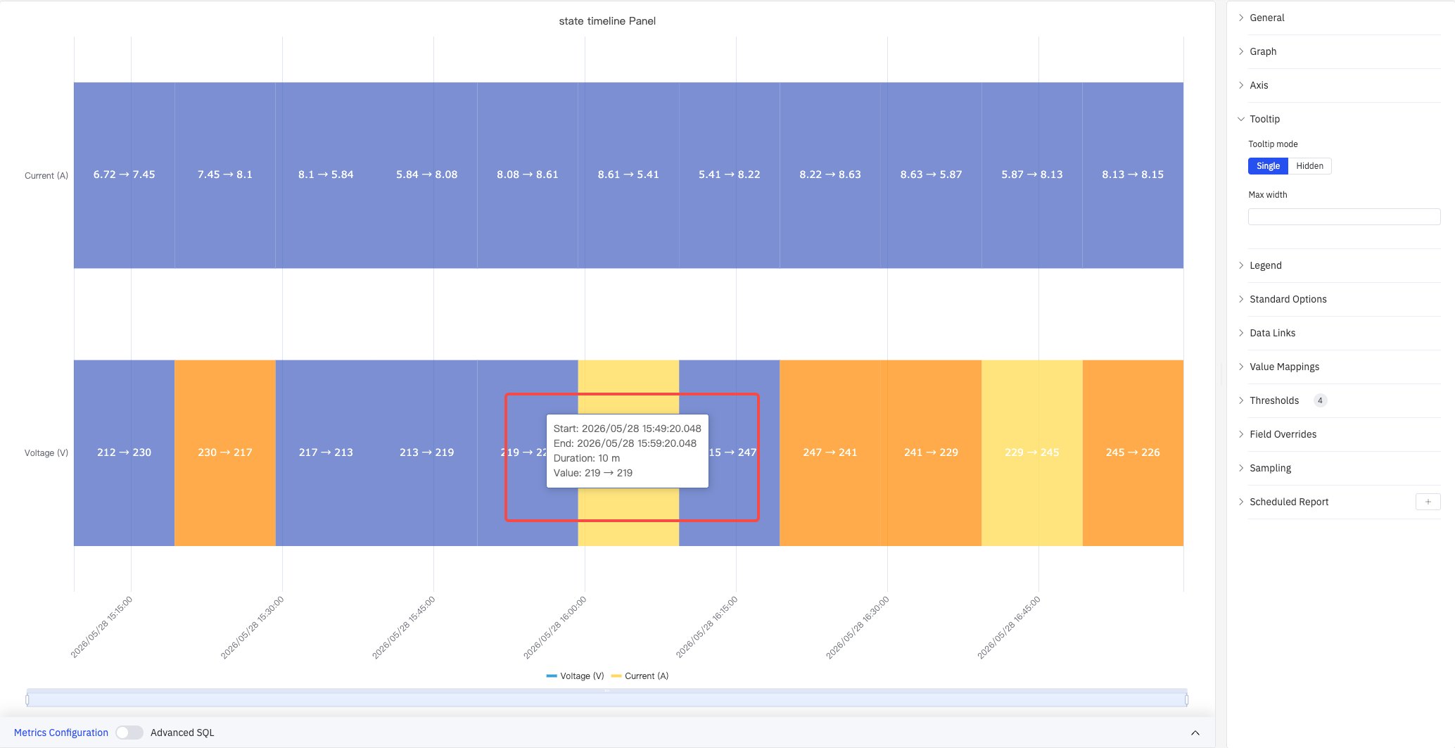

The State Timeline displays how a value changes over time as a horizontal colored band. Each segment of the band is colored and labeled according to the value it represents, making it easy to see at a glance how long a process was in each state and when transitions occurred.
Multiple metrics render as multiple stacked horizontal bands, enabling side-by-side comparison of state histories across different signals.

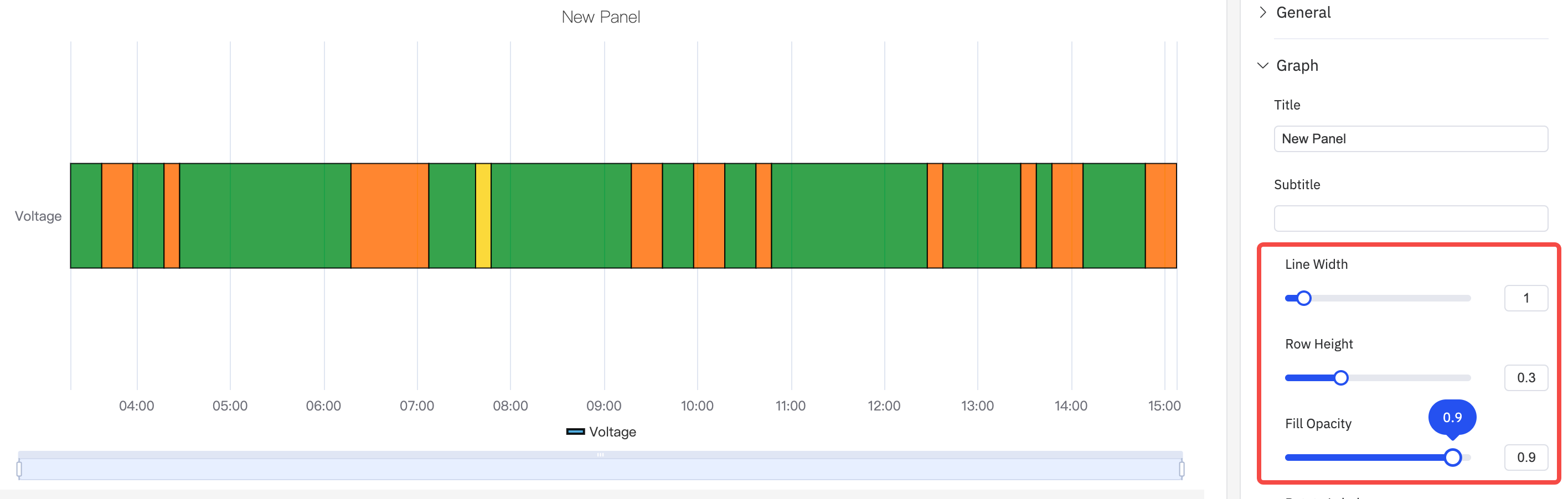

The appearance of each state band is controlled by the following settings:
| Setting | Description |
| Title | Chart title |
| Subtitle | Secondary title |
| Border Width | Width of the border drawn around each state segment (0 = no border) |
| Row Height | Relative height of each band (default 0.3) |
| Fill Opacity | Transparency of the state color fill, 0–1 |
| Rotate Labels | Rotation of X-axis time labels |
| Label Interval | Density of X-axis labels |

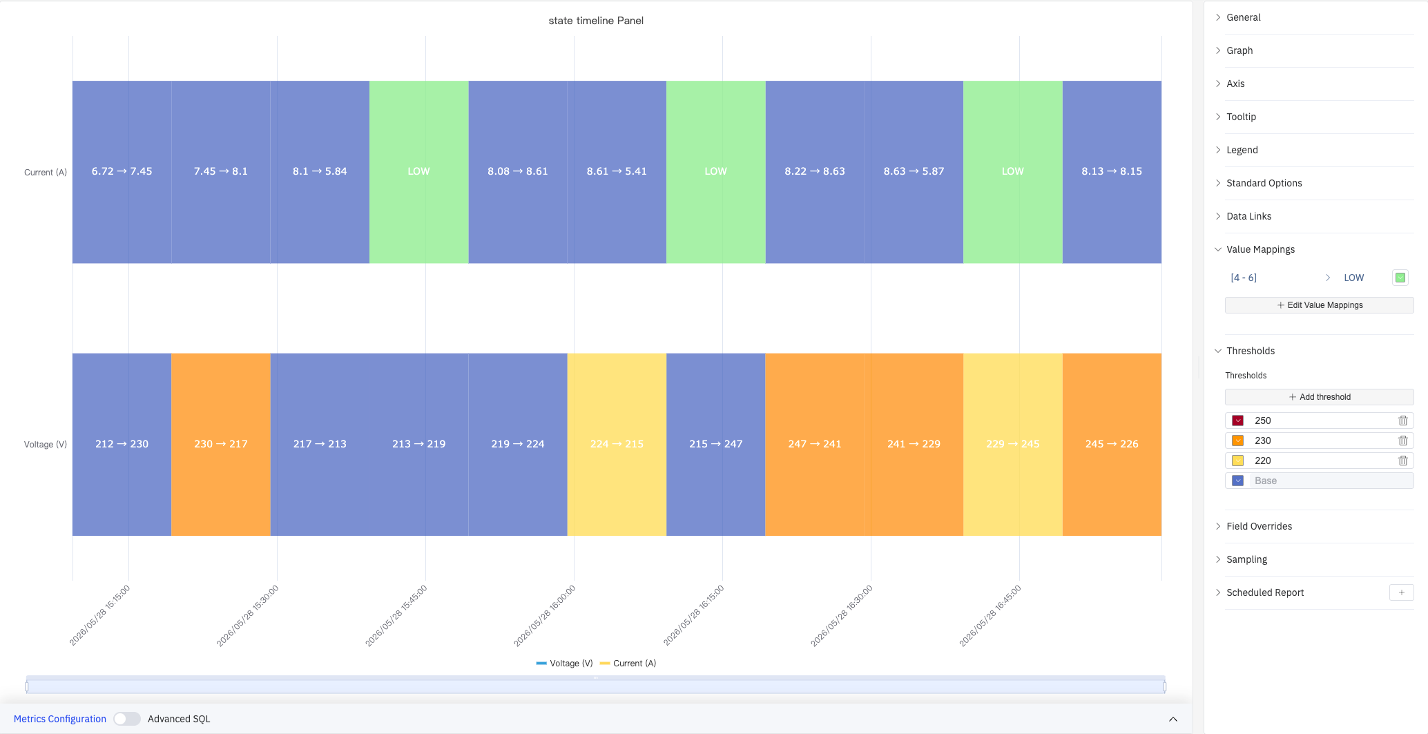

State colors and labels are determined by the Value Mapping configuration, where you map each value (e.g., 0, 1, "Running") to a display color and text label.

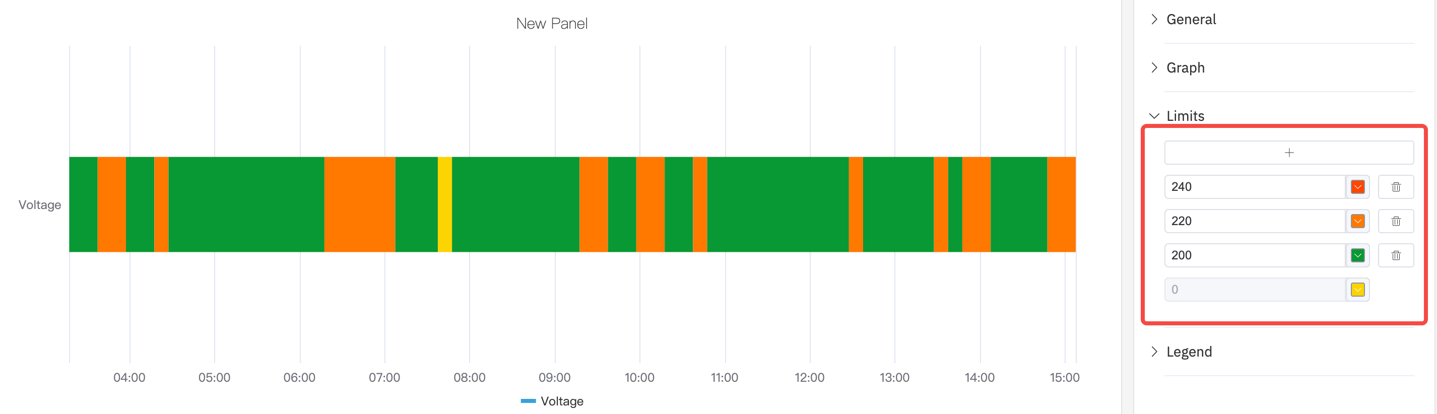

Limits Settings
Limit lines can be overlaid on the timeline to mark threshold values:

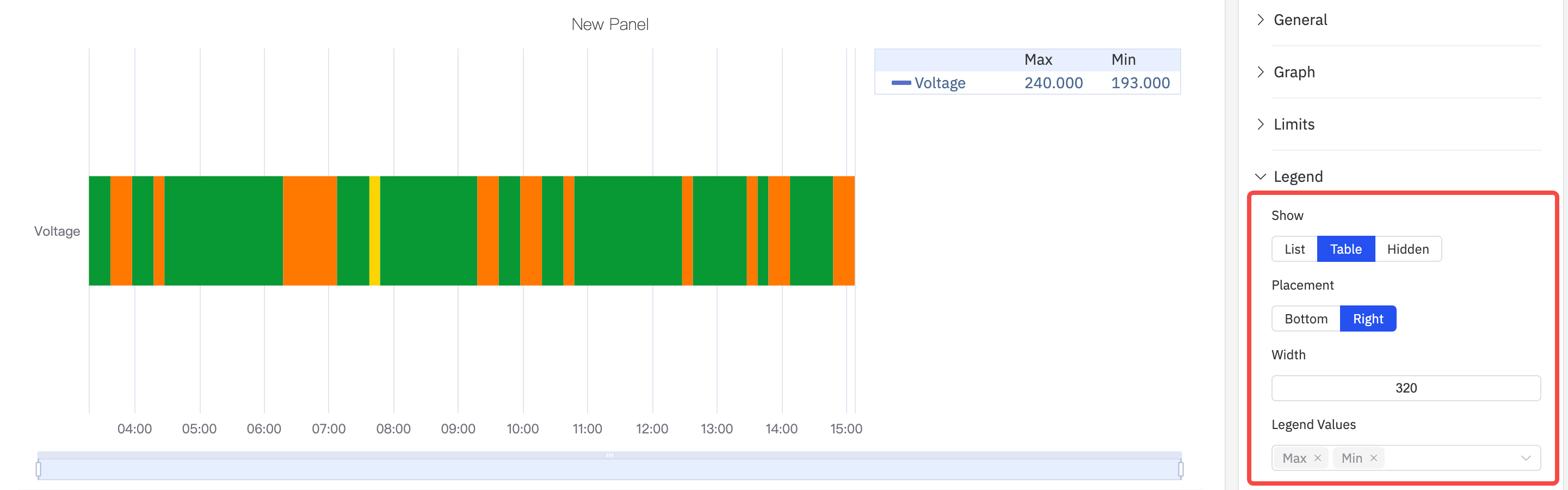

Legend Settings
The legend identifies each state color. In Table mode it can also show summary statistics:
| Show | Display mode: List, Table, or Hidden |
| Placement | Position: Bottom or Right |
| Legend Values | Statistics shown in Table mode |

Equipment on/off history. A pump's run state (0 = Off, 1 = Running) is mapped to gray and green respectively. The state timeline over a 24-hour period shows exactly when the pump was running and for how long each run lasted.
Multi-mode process timeline. A batch reactor has four operating modes: Heating, Reaction, Cooling, Idle. Each mode is mapped to a distinct color. The timeline shows the full batch cycle from start to finish and makes it immediately visible if any phase ran longer than expected.
Alarm active/inactive history. Multiple alarm signals are stacked as separate bands. A maintenance engineer reviews a week of history to identify which alarms were most frequently active and whether they correlate in time.
