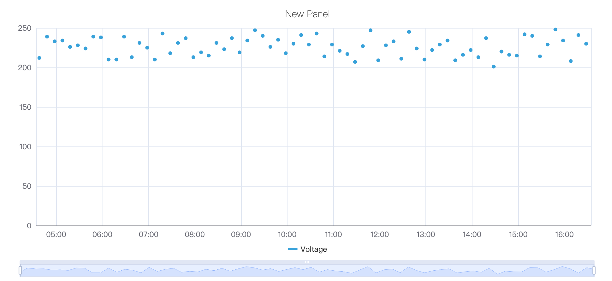

The Scatter Chart plots individual data points as dots in a two-dimensional space. In the default mode each point's X position is the timestamp and its Y position is the metric value — a time-scatter view. For correlation analysis, two attributes are plotted against each other (Y vs. X), revealing the relationship between the two variables.

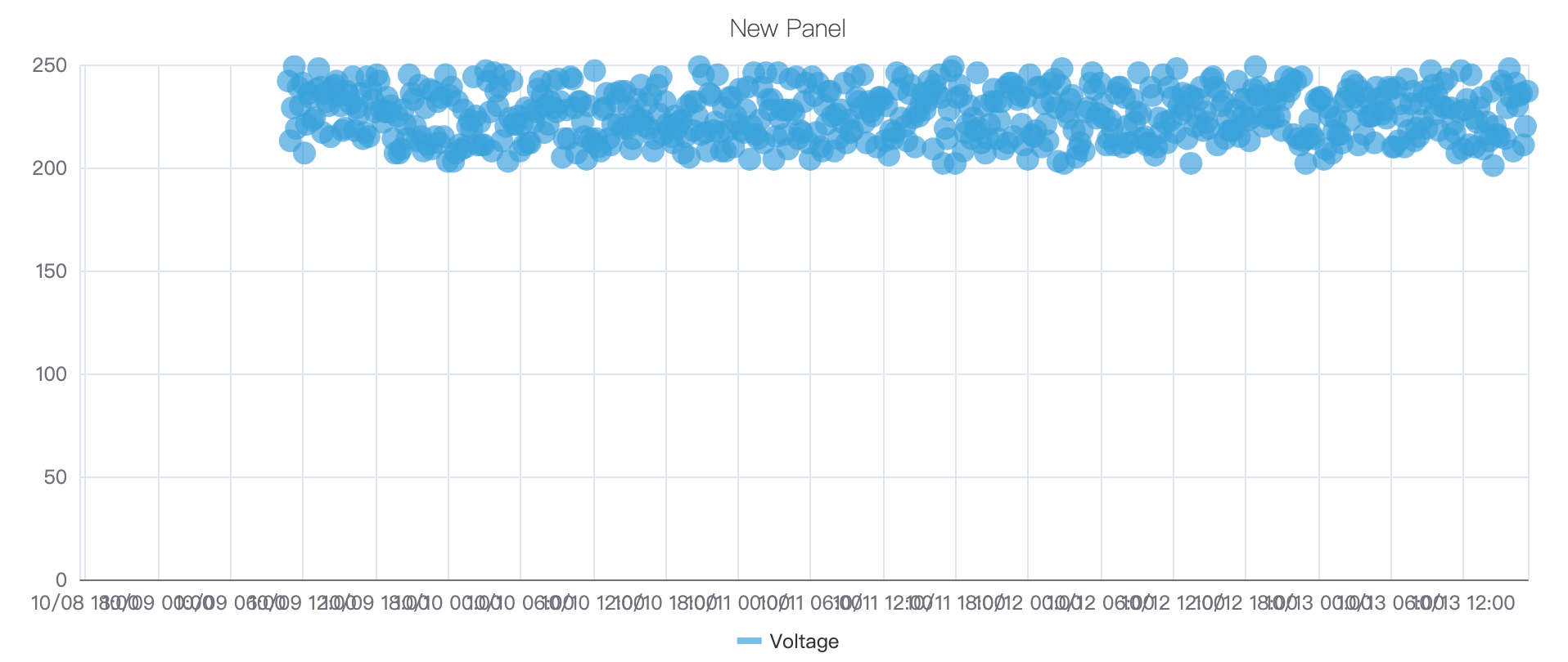

- You want to plot raw, unsampled data points without aggregation

| Disable Sampling | Fetch raw data without downsampling to ensure all individual data points are plotted |

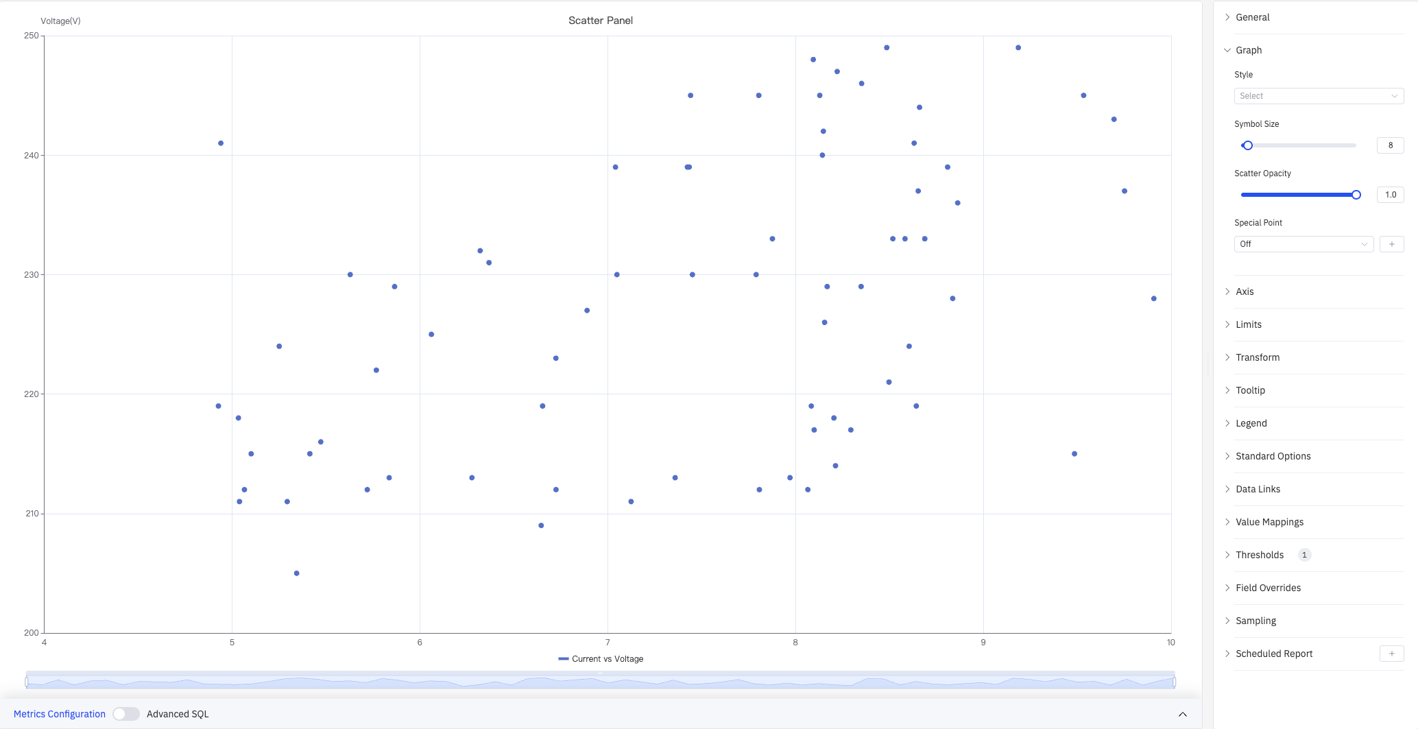

Graph Settings

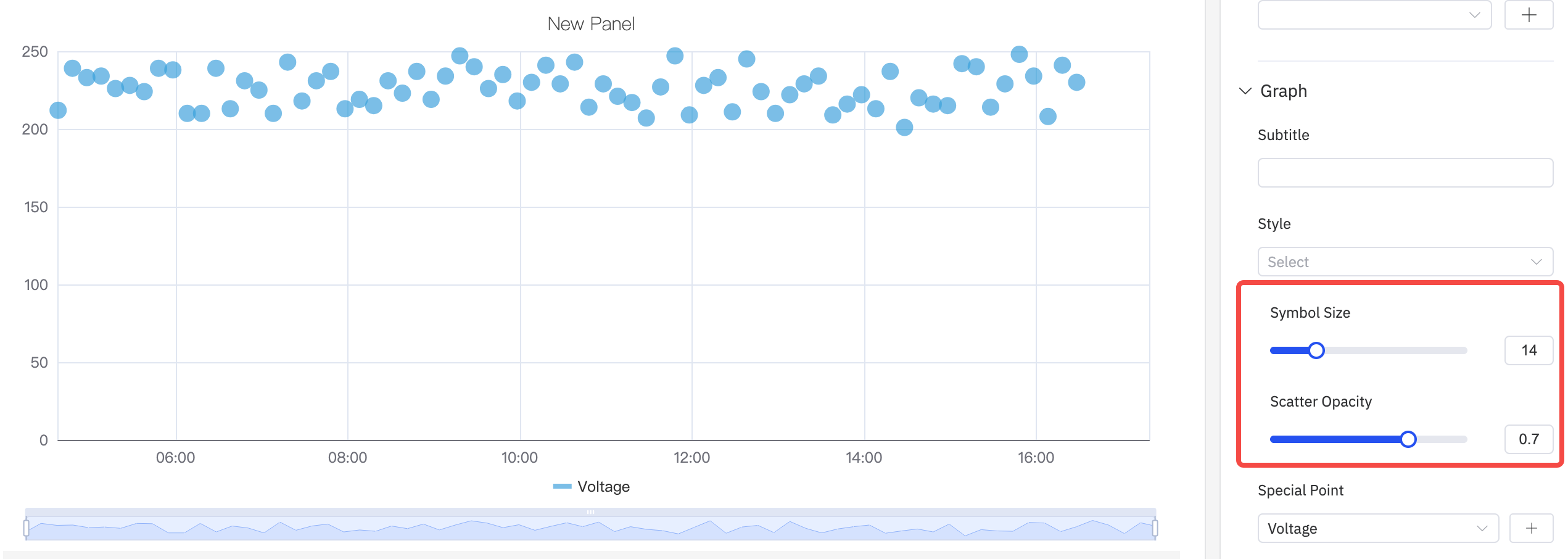

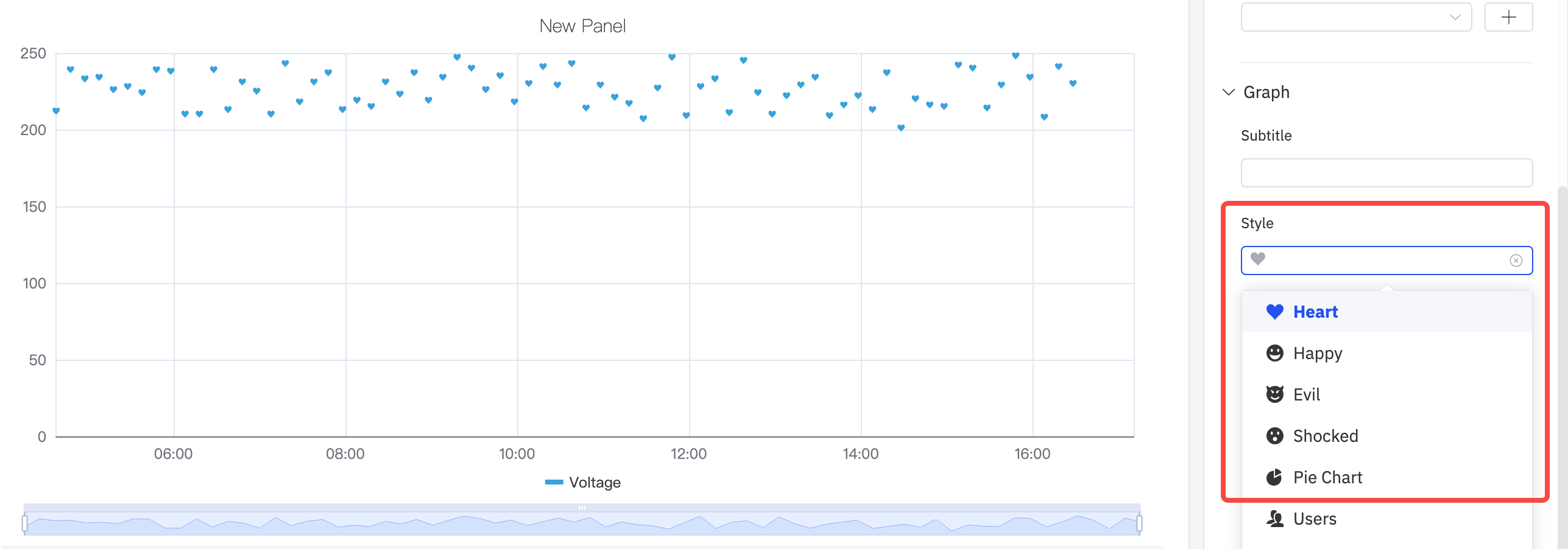

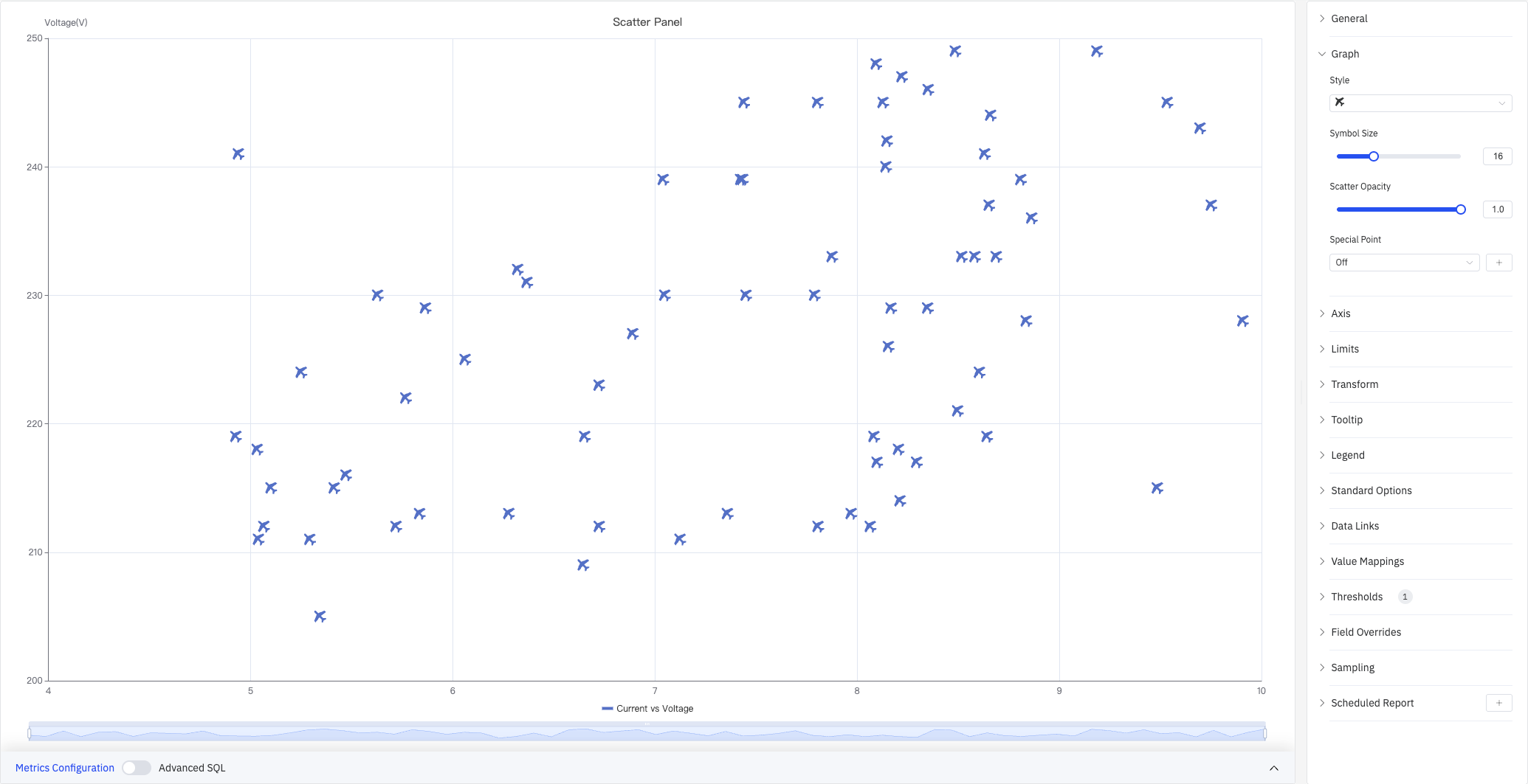

Point Style
The symbol shape, size, and opacity of each data point are configurable:

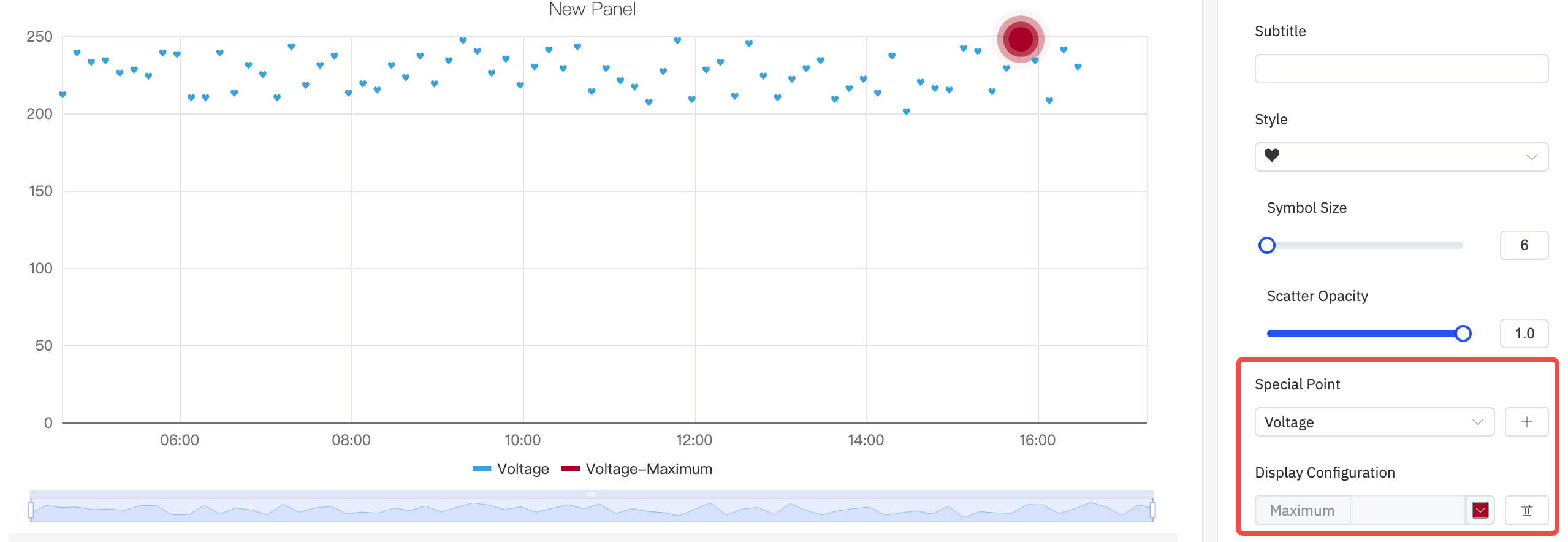

Special Points
The Special Point setting highlights specific data points — such as the maximum or minimum value — with a distinct marker and custom color:

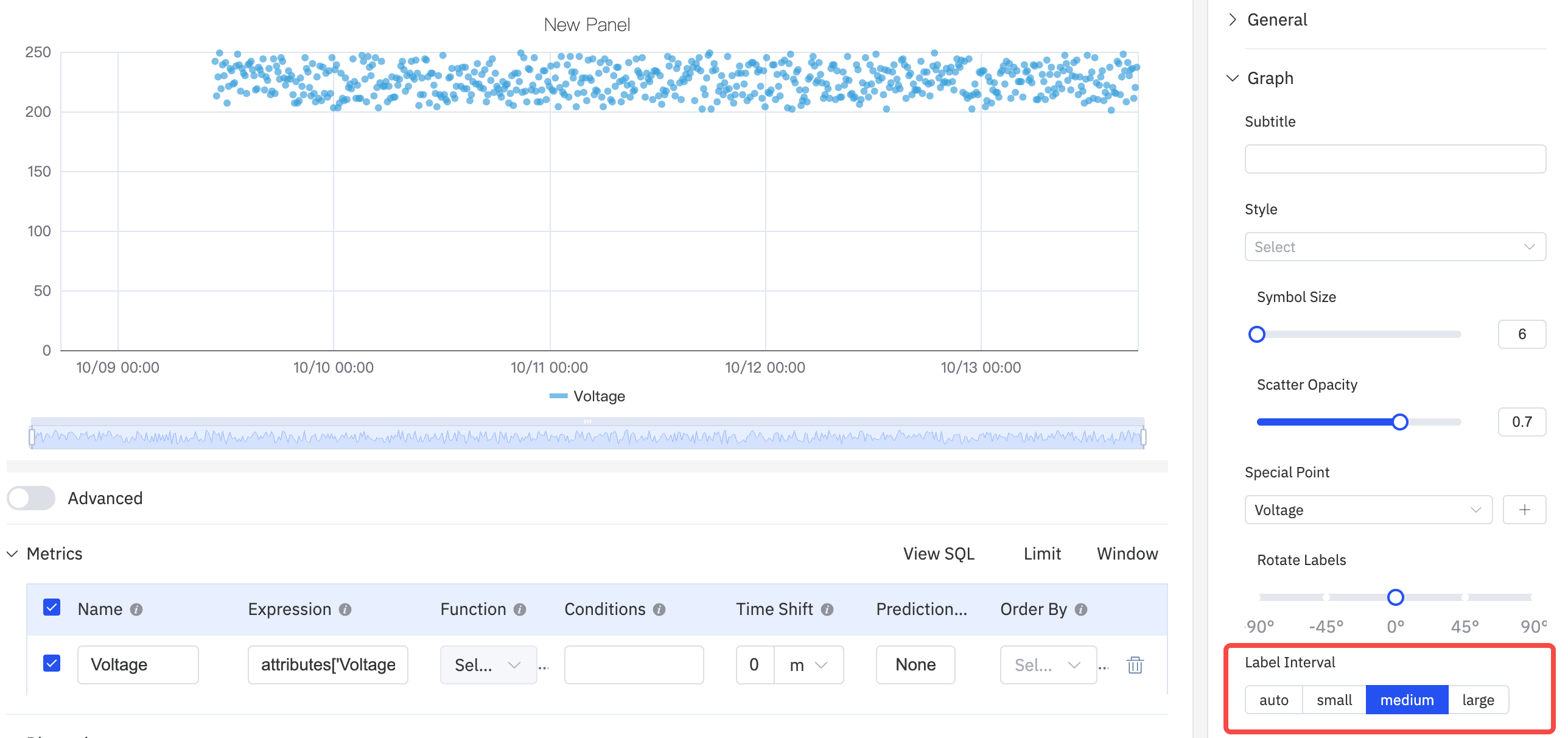

Labels
When data is dense, axis labels can overlap. Use Rotate Labels and Label Interval to improve readability:
| Setting | Description |
| Style | Symbol shape for data points (circle, heart, smiley, and others) |
| Symbol Size | Size of each dot (slider, default 6) |
| Scatter Opacity | Transparency of dots, 0–1 |
| Special Point | Highlight max/min or other specific points with a distinct marker |
| Rotate Labels | Rotation angle for X-axis labels |
| Label Interval | Density of X-axis labels |

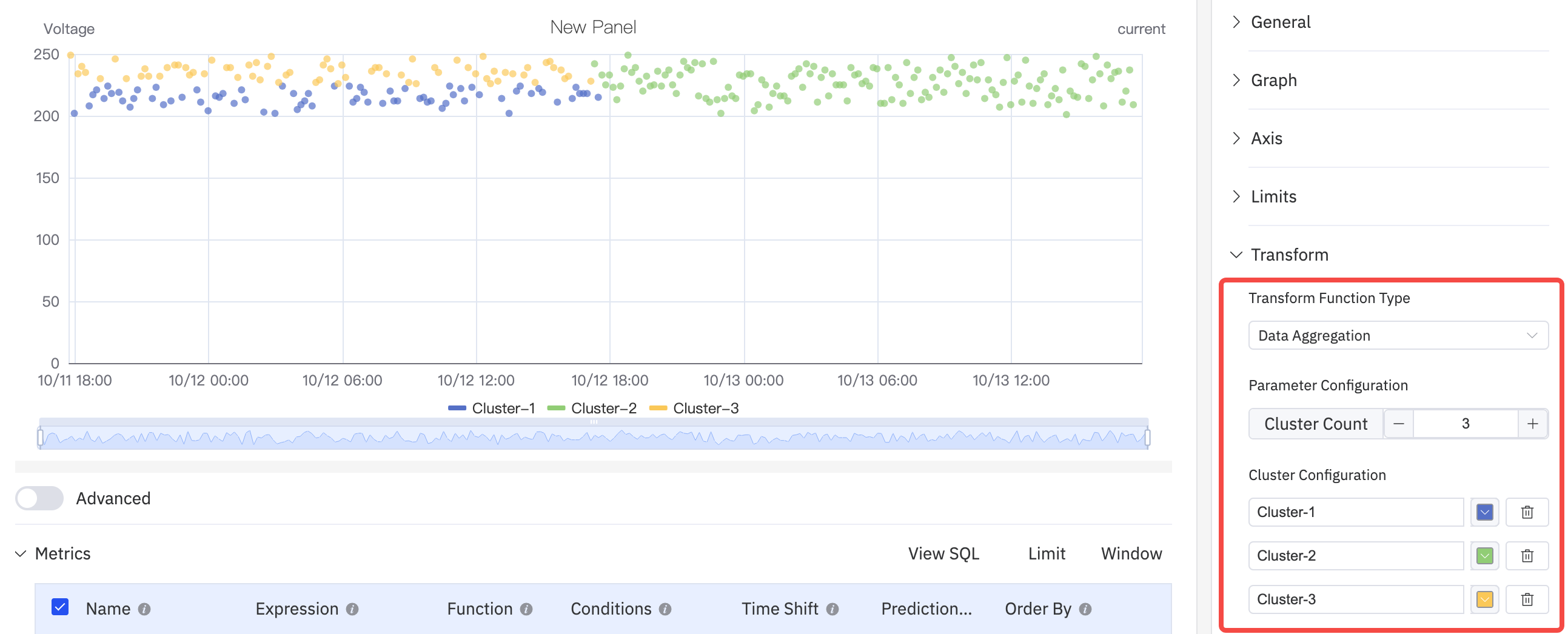

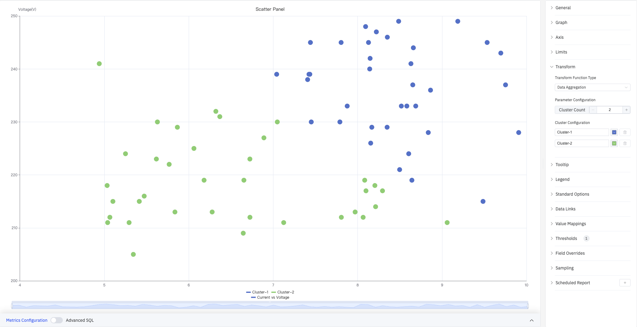

Data Aggregation groups points into clusters, displayed with distinct colors to enable visual clustering analysis:

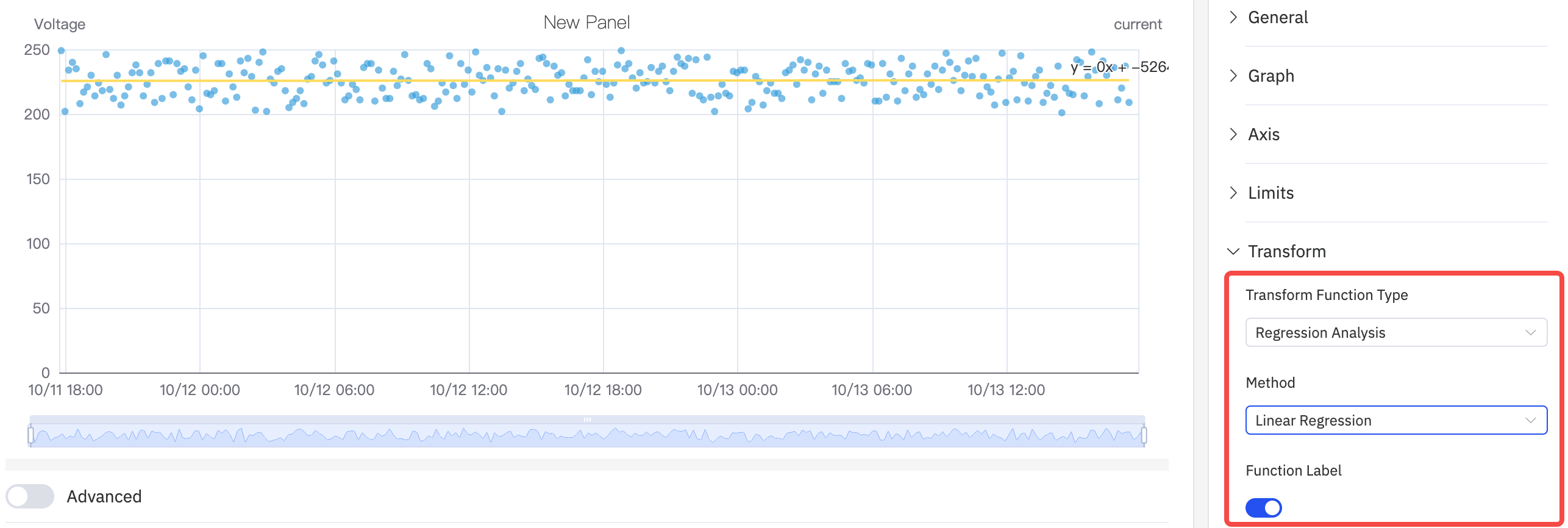

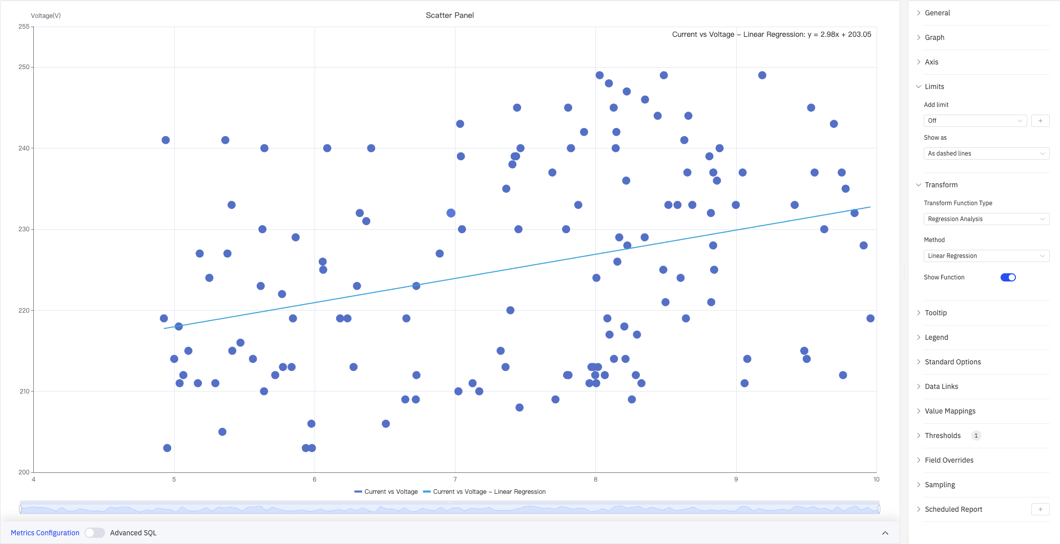

Regression Analysis fits a curve to the data and overlays it on the scatter plot. Supported functions include linear regression, exponential regression, and polynomial regression (with configurable degree):
| Transform Function Type | Description |
| Off | No transform; raw data points are plotted |
| Data Aggregation | Groups data points and displays aggregated clusters |
| Regression Analysis | Fits a regression curve (linear, exponential, or polynomial) to the data |

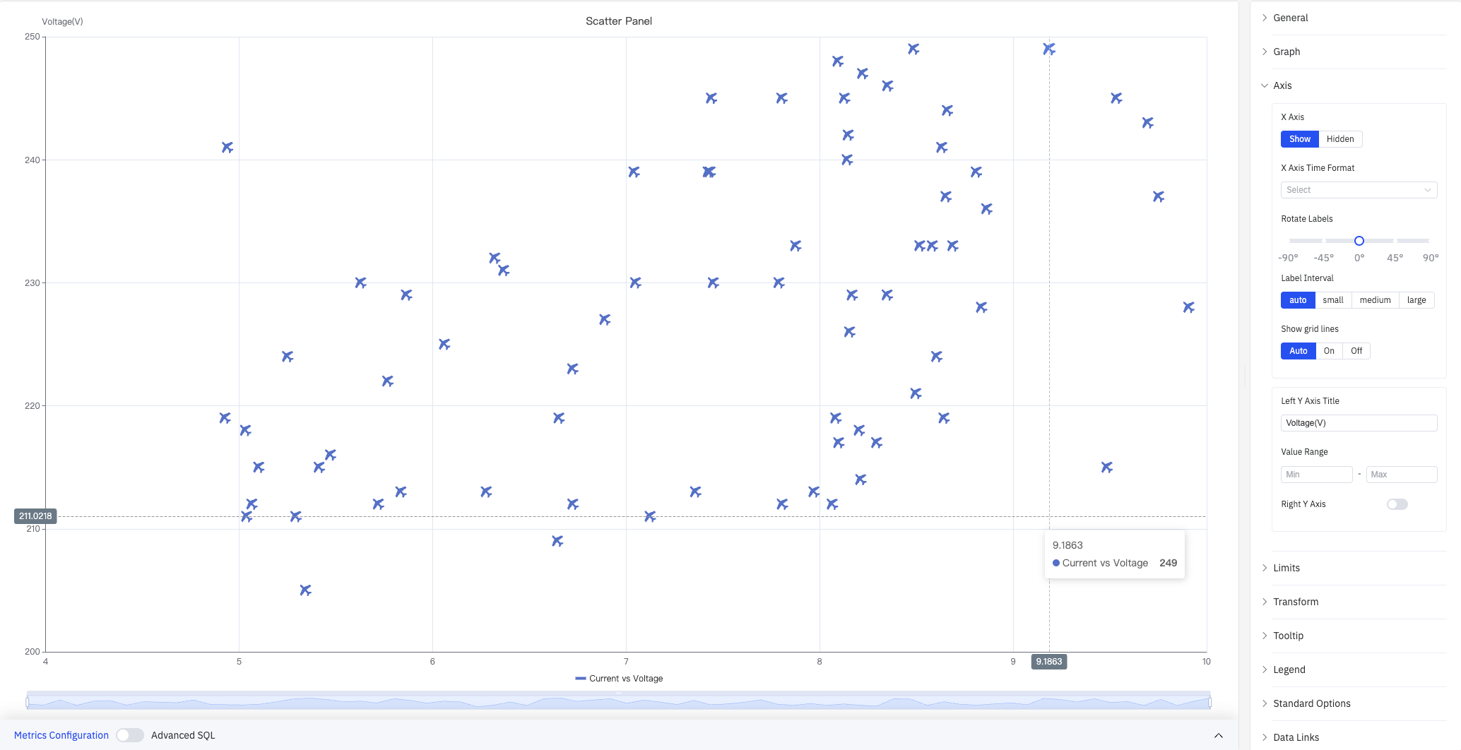

Axis Settings

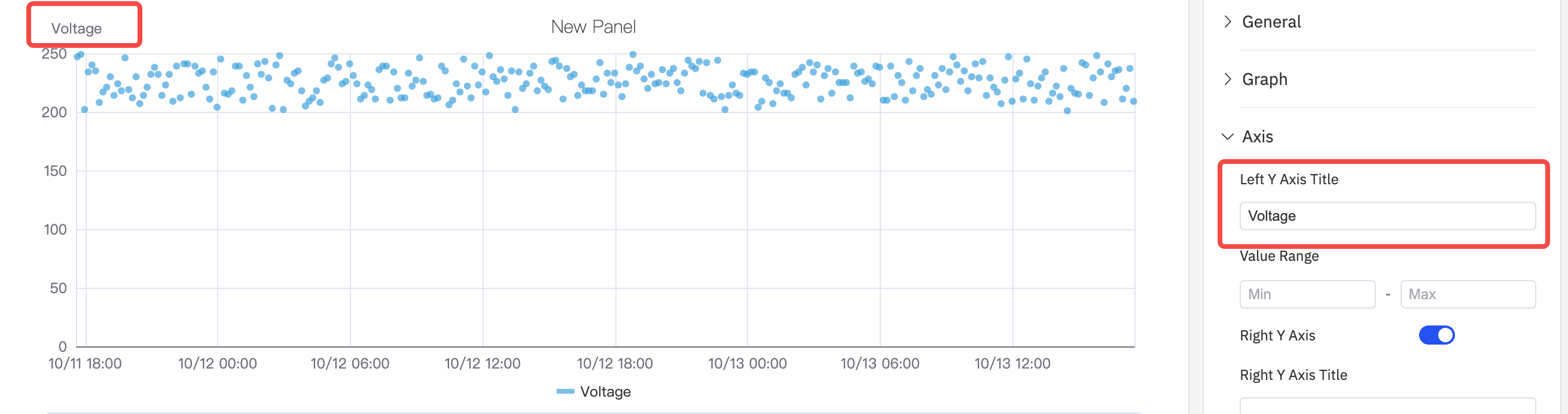

Axis Title
Configure Y-axis labels with names and units:

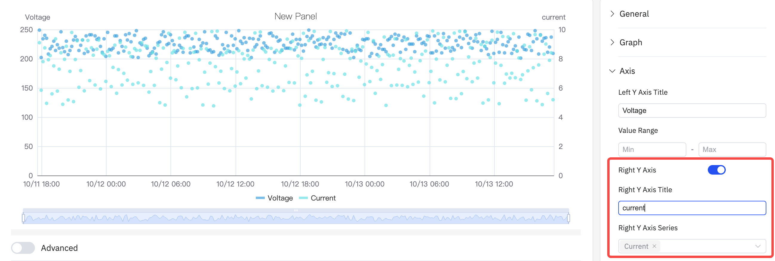

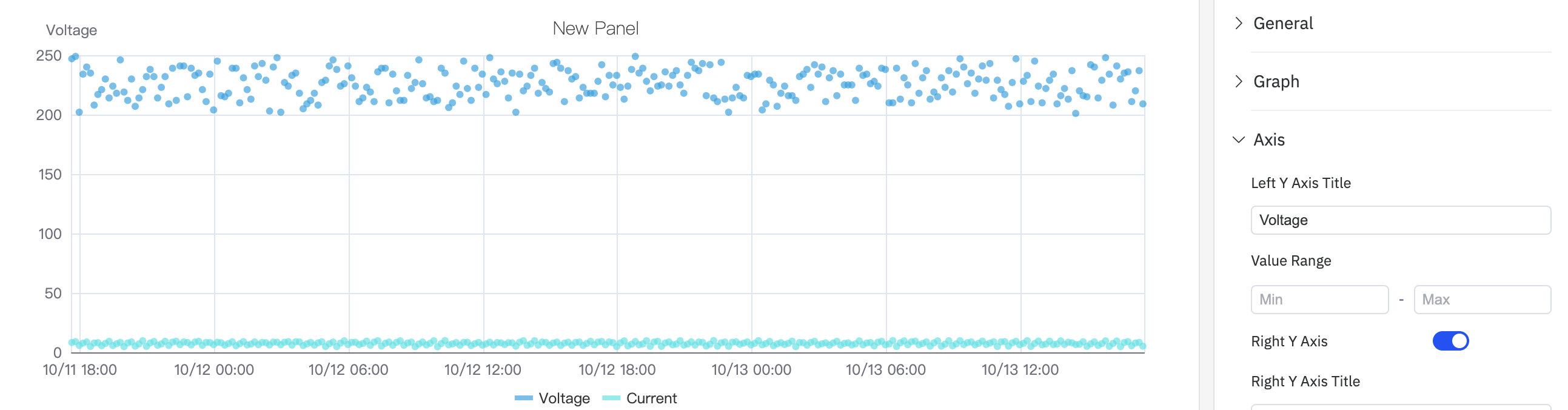

Dual Y Axis
When two metrics have very different scales, a shared Y axis compresses the smaller signal. Enabling the Right Y Axis assigns each to its own scale:

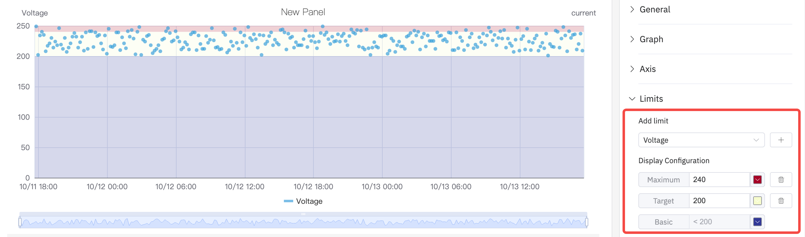

Limits Settings
Limit lines can be overlaid on the scatter plot to mark operating boundaries:

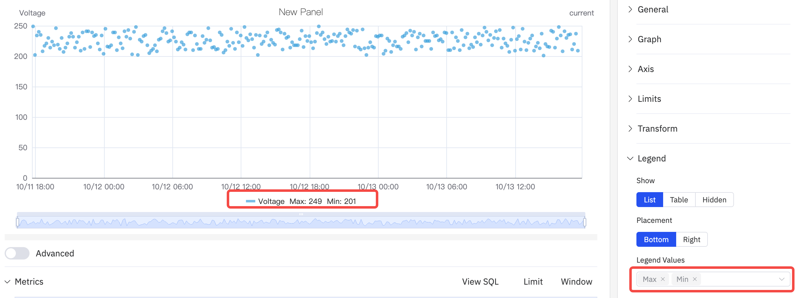

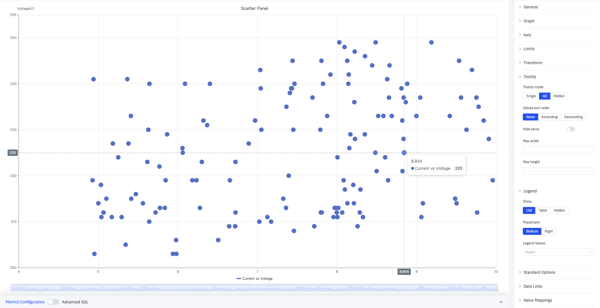

Legend Settings
In Table mode, the legend shows summary statistics. When placed on the Right with Table mode, the legend table width is also adjustable:
| Show | Display mode: List, Table, or Hidden |
| Placement | Position: Bottom or Right |
| Legend Values | Statistics shown in Table mode: Last, Min, Max, Mean, Sum, etc. |

Power vs. temperature correlation. A process engineer plots active power (X dimension) against motor temperature (Y metric) over a month of data. The scatter plot reveals a clear positive correlation — the regression curve quantifies the relationship and the R² value indicates its strength.
Quality clustering. A quality engineer plots two process variables (pressure and temperature) for all batches in a quarter. Data Aggregation colors the clusters — most batches cluster tightly in the green zone, but a handful of outliers in a separate cluster correlate with the failed batches.
Outlier detection. A data engineer enables Disable Sampling to plot every raw reading of a sensor. The Special Point setting highlights the maximum value with a red marker. A clear outlier point significantly above the cluster is identified for investigation.
