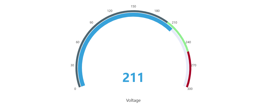

The Gauge Chart displays a single current value on a semicircular dial, similar to an analog instrument panel gauge. The needle and colored arc segments show at a glance where the value stands within its operating range.
Gauge chart displaying a real-time value on a dial
The gauge always shows the latest data point in the selected time range. Multiple gauges can be displayed in a single panel — one per metric — arranged horizontally or vertically.

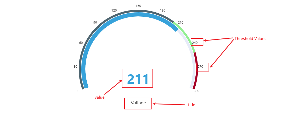

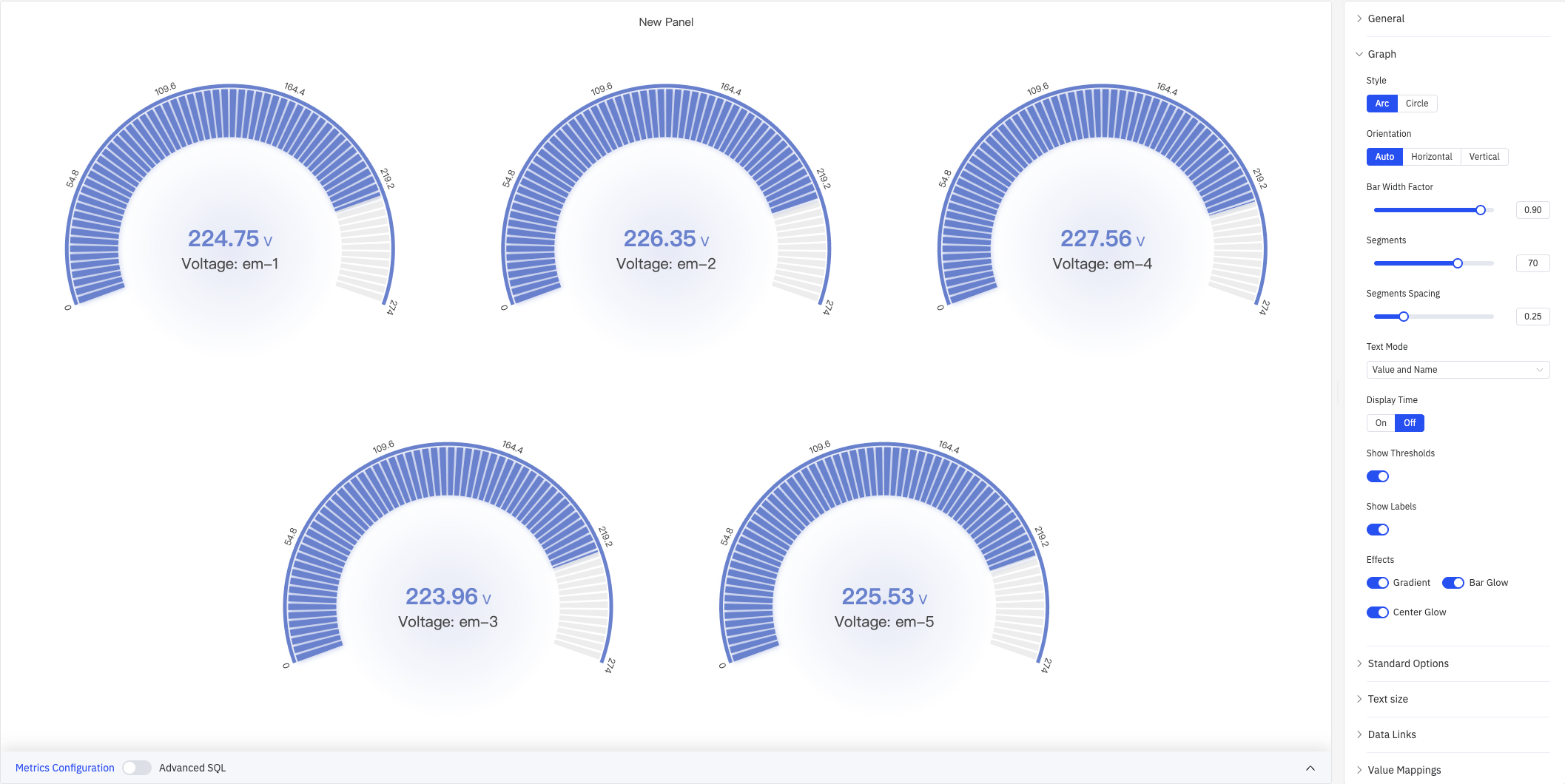

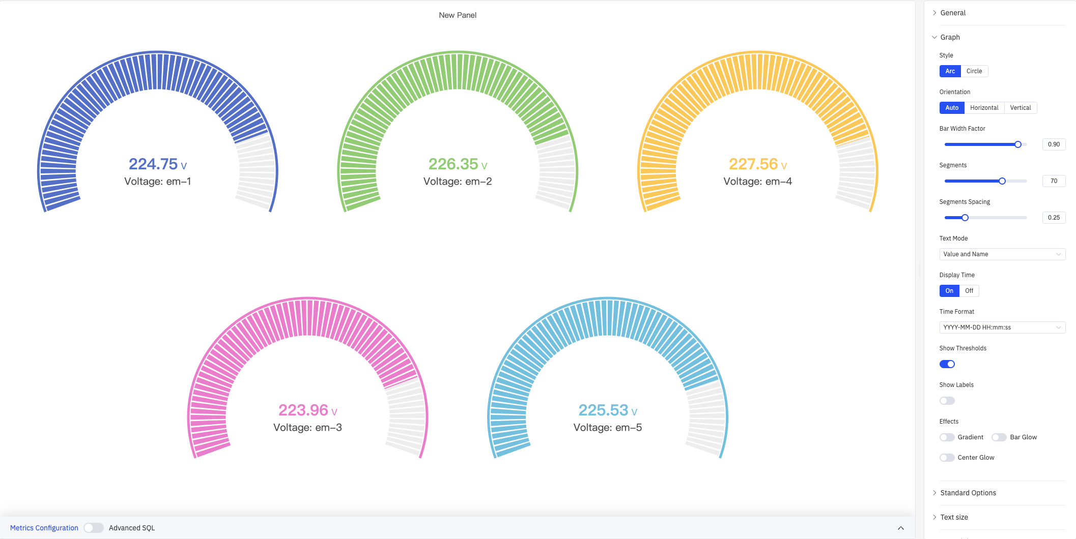

The gauge supports configuring the dial labels, title display, and font sizes:
Gauge with threshold labels and metric name displayed
SettingDescription
TitleChart title displayed above the panel
OrientationLayout direction when multiple gauges are shown: Horizontal or Vertical
Show threshold labelsToggle: display threshold values around the dial arc
Show TitleToggle: display the metric name below the dial
Title Text sizeFont size for the metric name label (default 16)
Value Text sizeFont size for the numeric value at the center of the dial (default 48)
Limits Settings

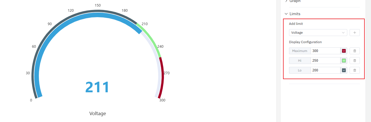

Attribute-defined limits — LoLo, Lo, Target, Hi, HiHi — are rendered as colored arc segments on the dial. This visually divides the gauge face into safety zones, making it immediately clear when the needle is in a warning or alarm region:
Gauge with colored arc segments marking operating zones
Limits are inherited from the attribute configuration on the element and do not need to be re-entered here.

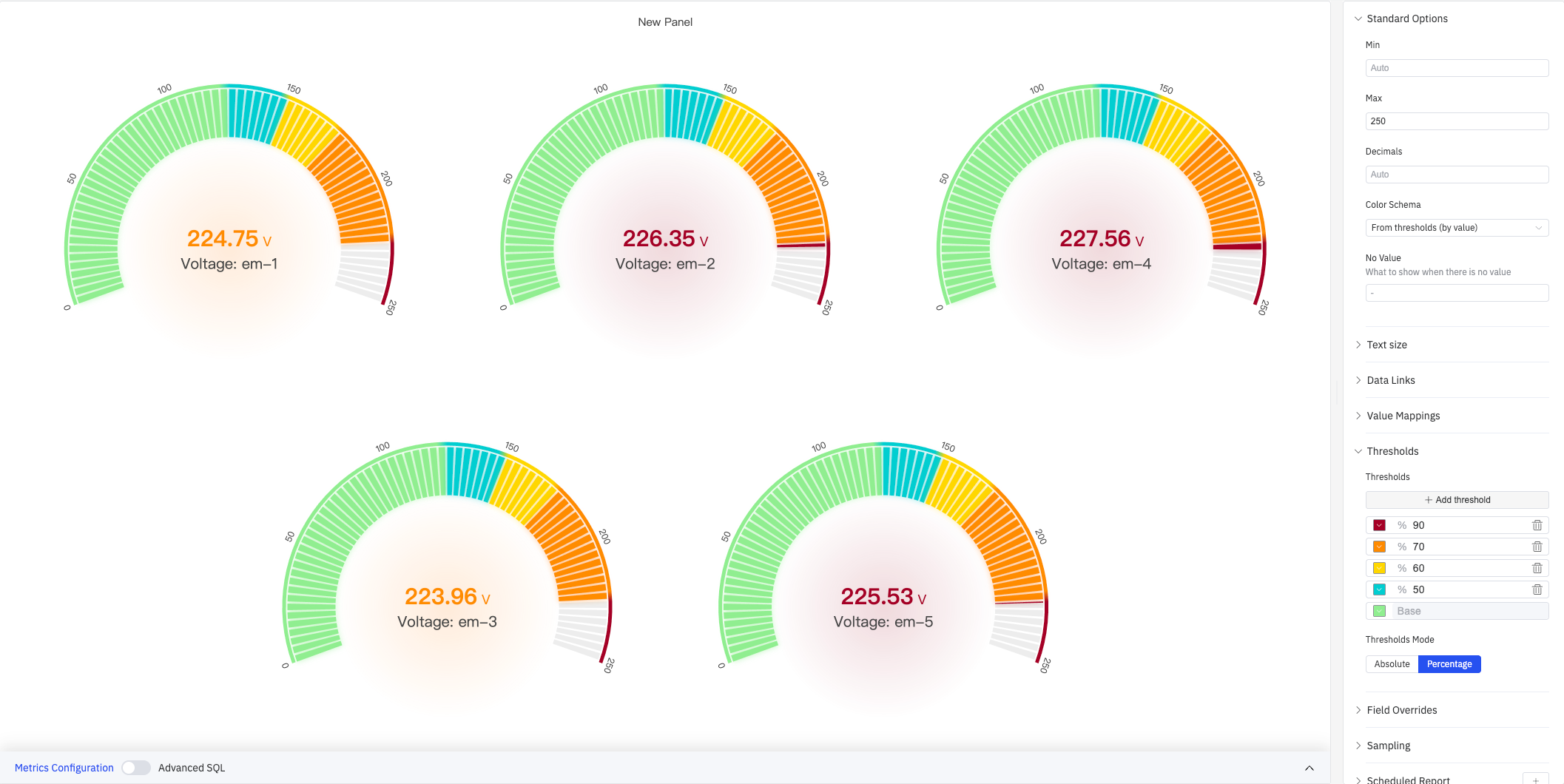

Motor speed monitoring. Three motors on a production line each contribute one gauge to the same panel with Horizontal orientation. The operator sees all three speeds side by side and immediately spots the one running outside the normal zone.
