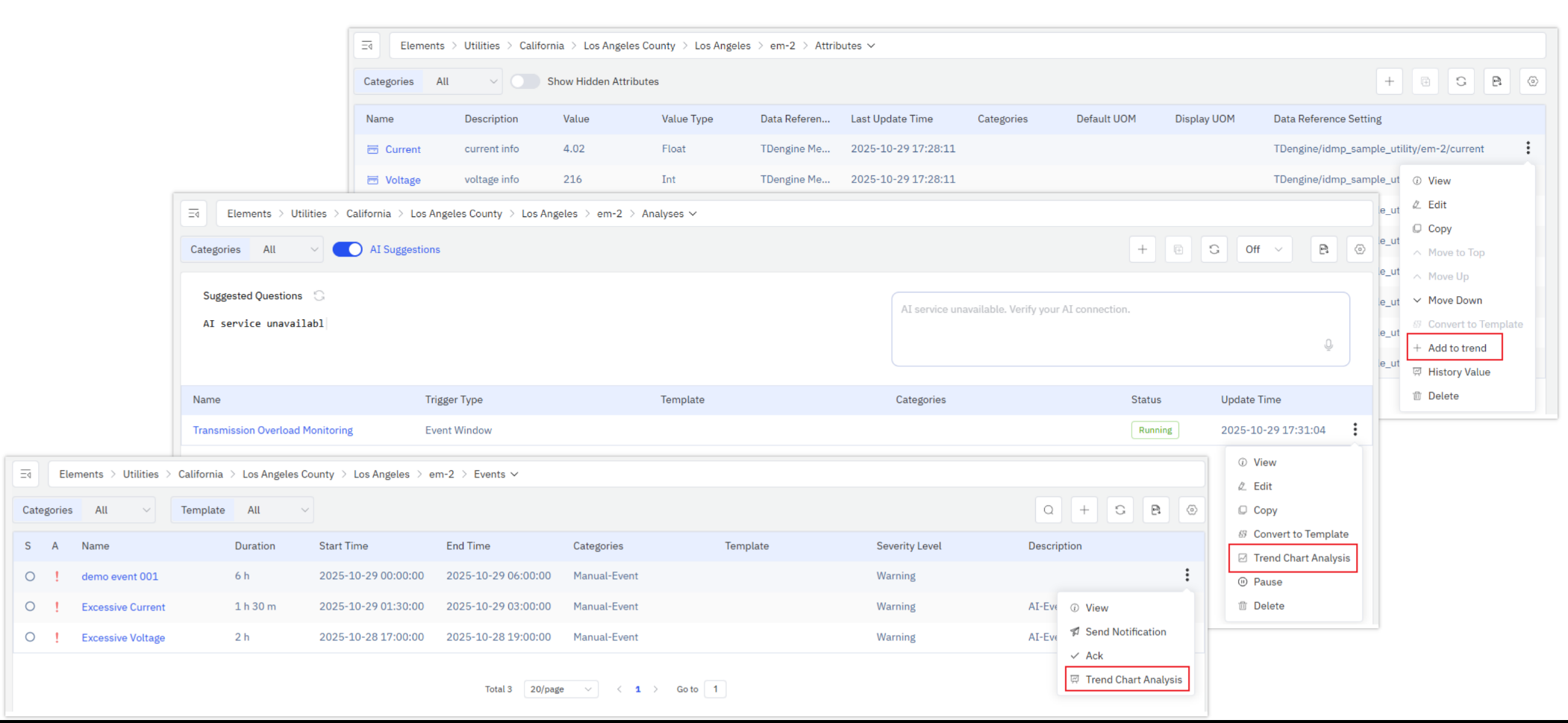

Click Add to include data in the Event Trend panel. Three source types are supported:
Adding attributes, events, and analyses to Event Trend
Source TypeEffect
AttributeAdds a time-series line for the selected element attribute
EventAdds all attributes associated with the event's trigger conditions and highlights the event's active time range on the chart
AnalysisAdds all attributes referenced by the analysis and overlays all events generated by the analysis

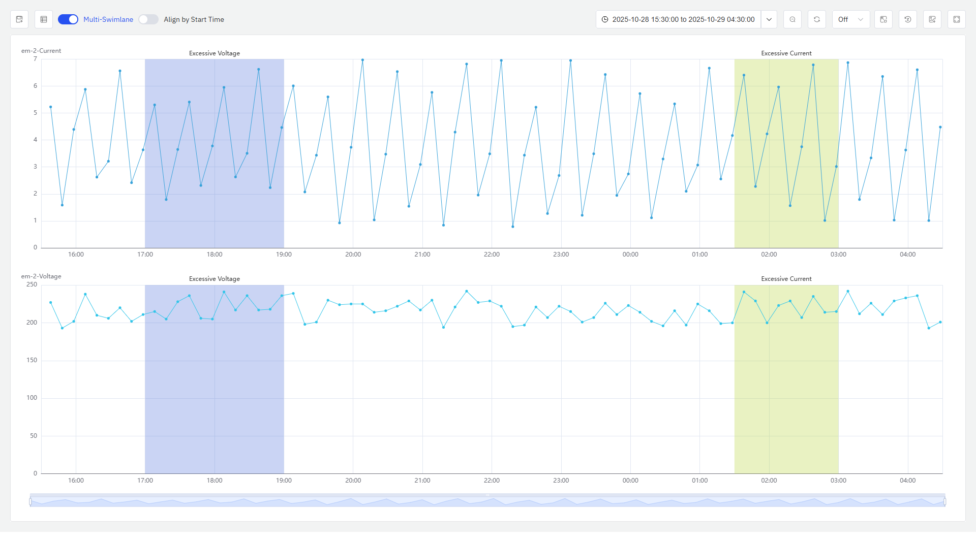

Multi-Swimlane
Multi-swimlane mode is enabled by default. In this mode each metric occupies its own horizontal band, keeping signals with different scales visually separated and readable.

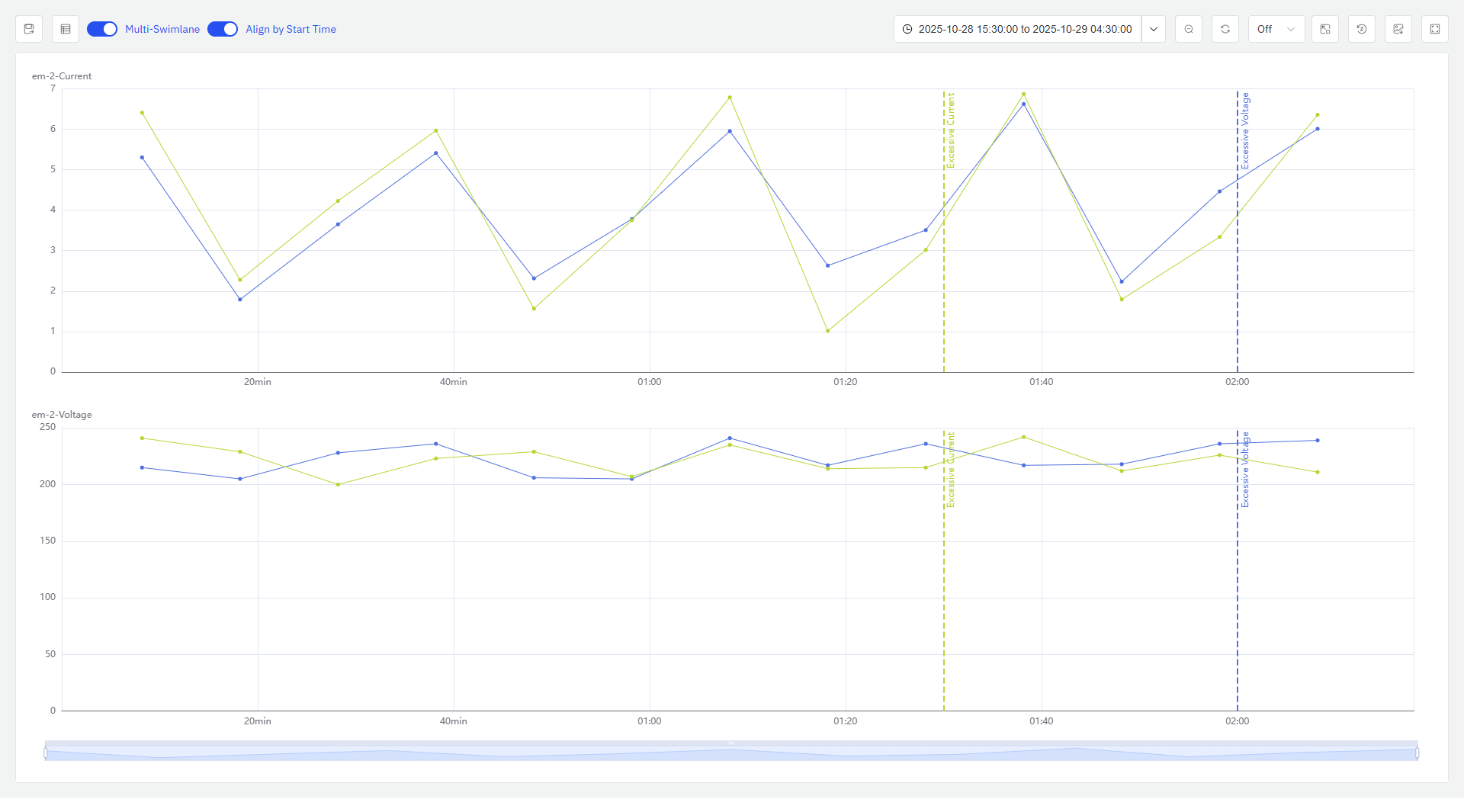

Align by Start Time
When disabled (default), each event interval is shown at its actual calendar time. When enabled, all event occurrences are shifted to a common start point and overlaid on the same time axis — allowing you to compare how the associated metrics evolved across multiple event occurrences.

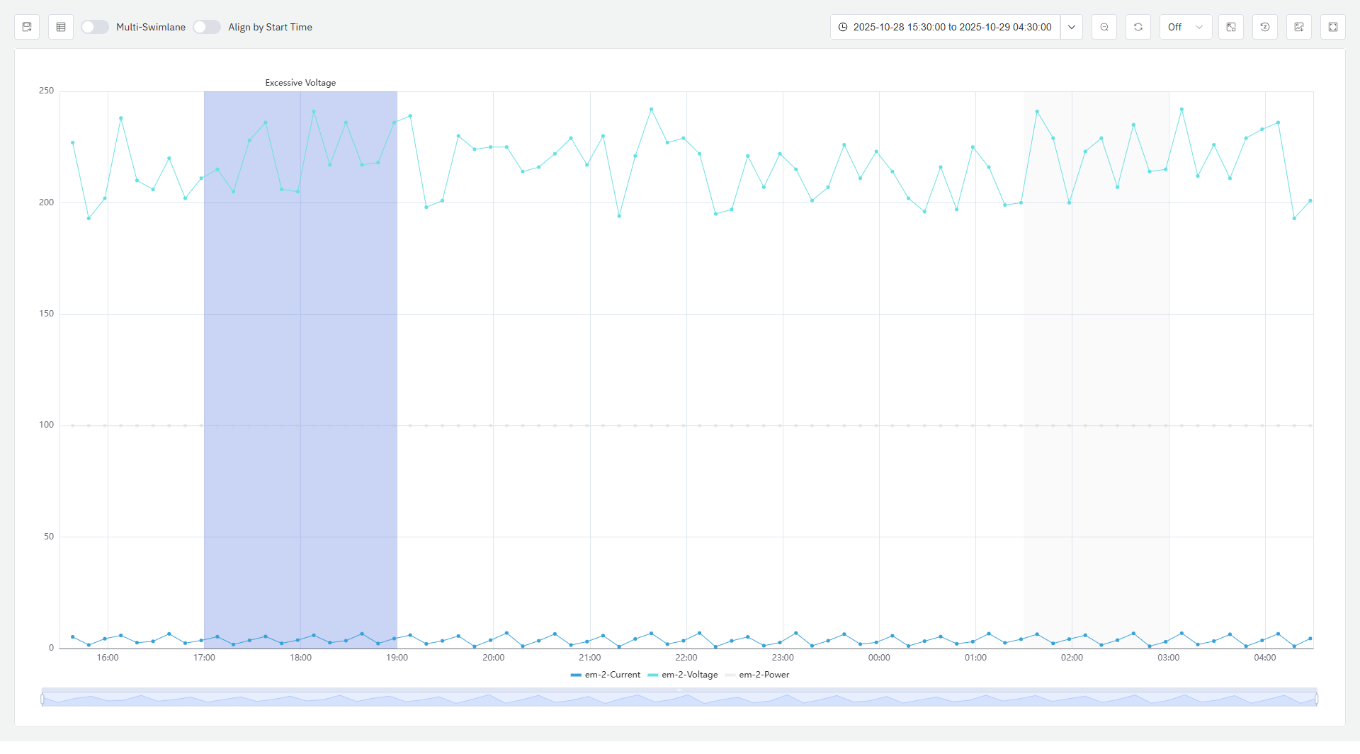

Highlight Event Metrics
When you hover over an event interval on the chart, the attributes associated with that event's trigger conditions are highlighted. All other metrics and event intervals are dimmed, making it easy to focus on the relevant signals for a specific event occurrence.

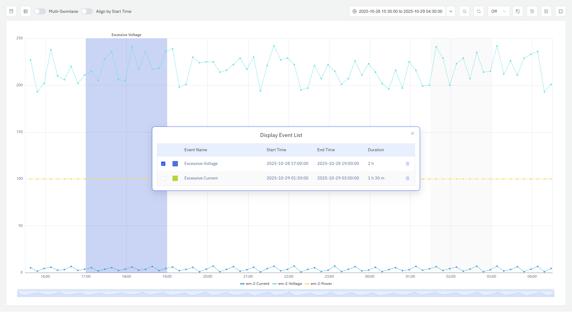

Event List
Click the Event List button in the upper-left corner to open the event list panel. The panel shows event name, start time, end time, and duration for all events currently displayed in the chart. The panel can be freely dragged.
Events in the list are checked by default. Checked events are highlighted on the chart; unchecked events are dimmed. Events can also be removed from the list.

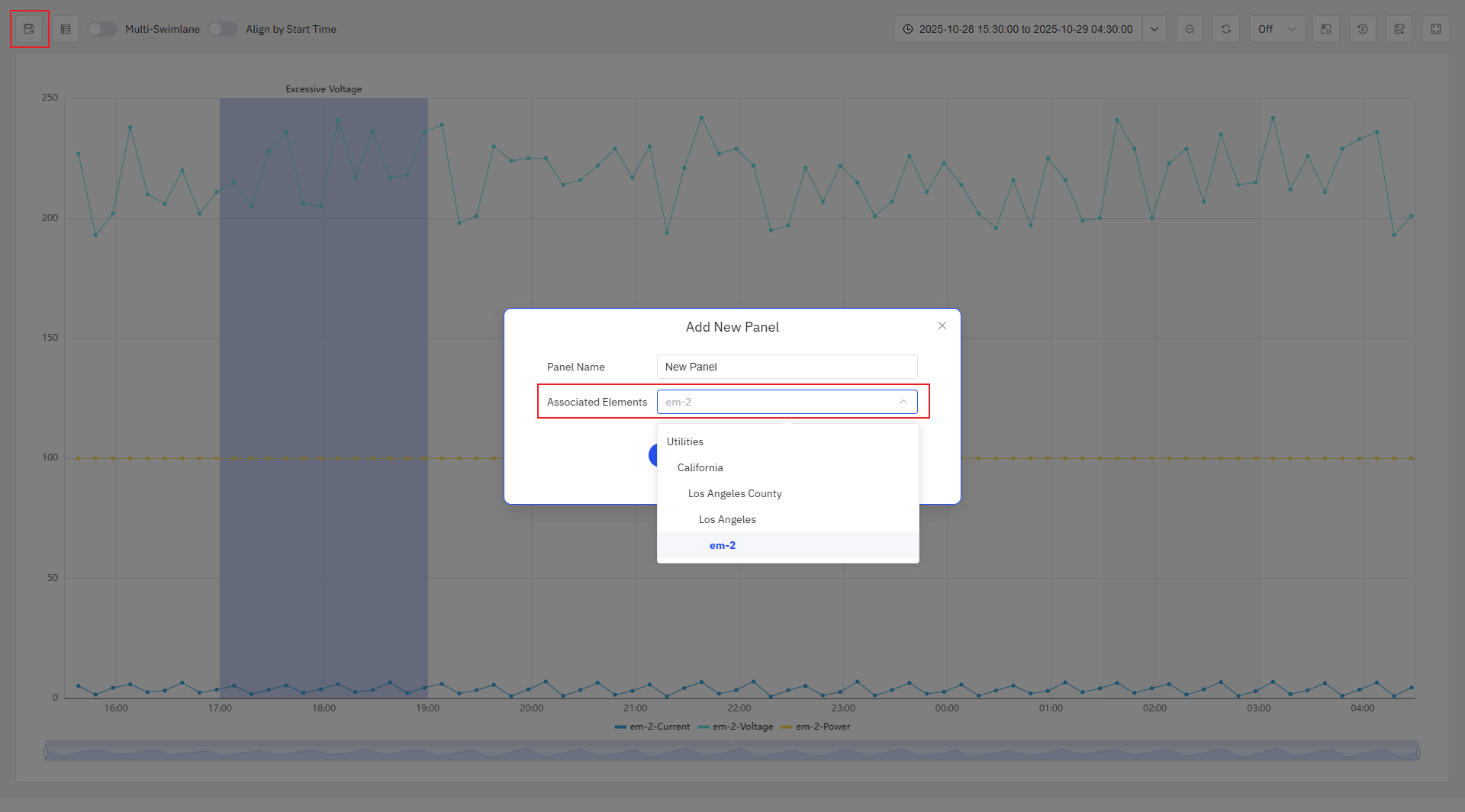

Saving as a Panel
Click Save in the upper-left corner to permanently save the current analysis view as a panel. In the save dialog, select the element under which to save the panel. The available options include the elements whose data is already in the current view, plus their ancestor nodes in the asset tree.
