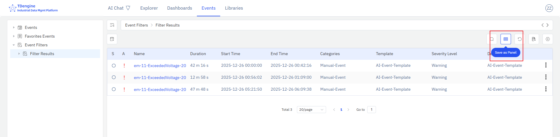

Saving an Event List Panel
Navigate to the Events main menu and click Event Filter in the left panel. Configure the filter conditions to scope the events you want to track. Click Save as Panel to save the current filtered event list as an Event List panel.
After saving, the panel preview opens automatically. You can also navigate to the target element's Panels tab to view the new Event List panel.
