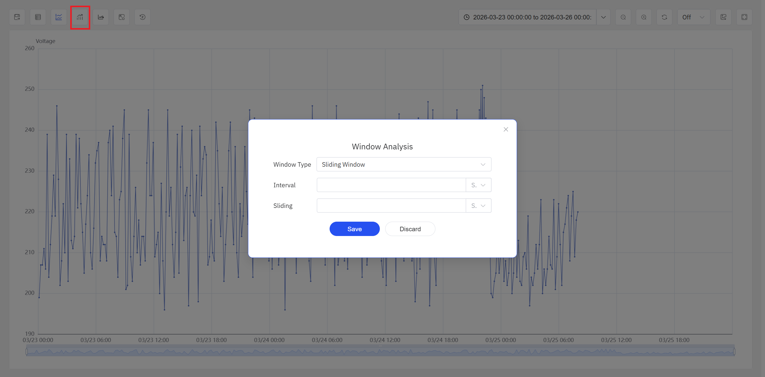

Window analysis is accessed from the Window Analysis icon in the Analysis Workbench toolbar while in view mode.
Steps:
  1. Click the Window Analysis icon in the toolbar to open the configuration dialog. Select a window type and configure the relevant parameters, such as condition expressions, state attributes, or time intervals.
Window analysis configuration

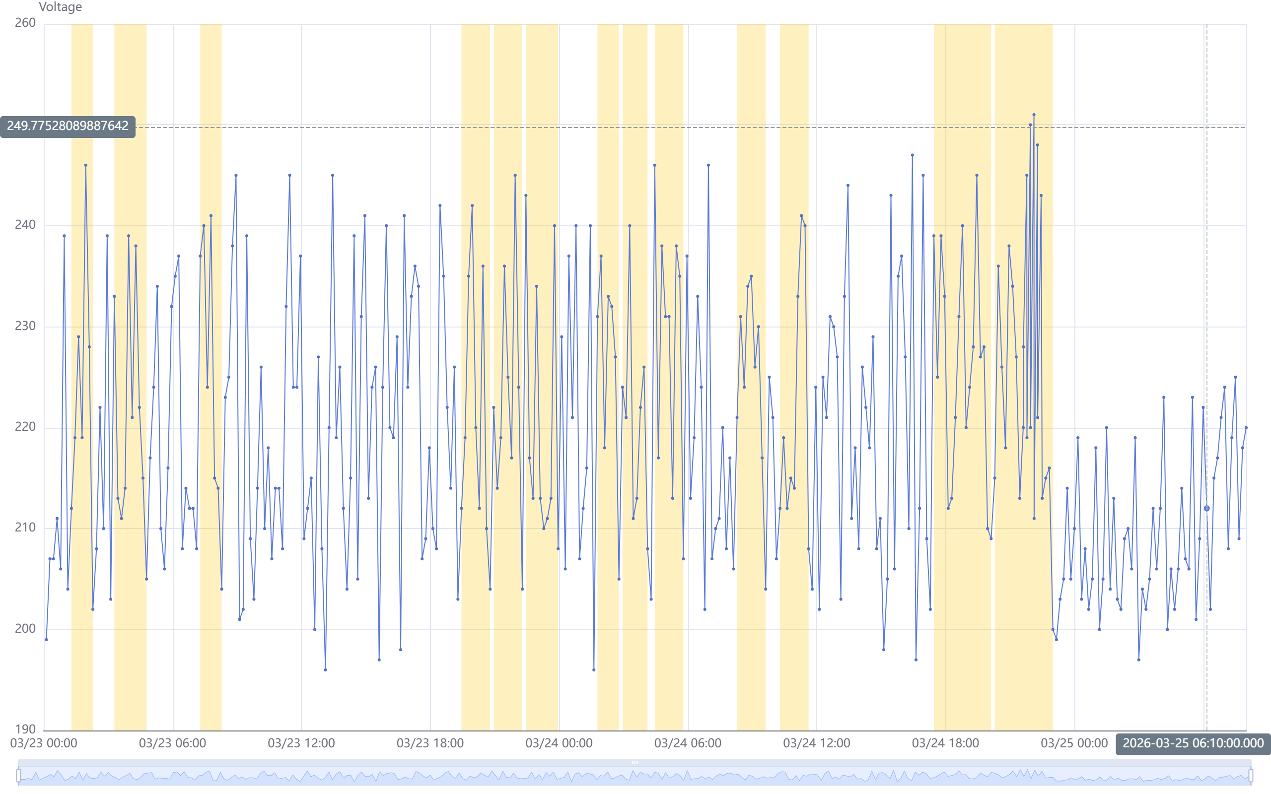

  1. After the window configuration is confirmed, IDMP scans the historical data in the current time range and renders the matched segments as highlighted windows in the Analysis Workbench. At that point, users can:
  • Run multiple window strategies in the same panel and compare the results side by side
  • Inspect the data behavior inside each highlighted window to decide whether deeper analysis is needed
  • Combine the result with event comparison, time alignment, normalization, or envelope analysis for further exploration
Window analysis result displayed on the chart

  3. The system scans 30 days of data and finds 12 low-temperature periods, highlighted on the chart.
  4. Switch the window type to Anomaly Detection, select the default algorithm, and run another search over the same time range. In addition to the low-temperature periods found above, the system identifies 3 additional segments where the temperature stayed within the 830–850°C range but exhibited oscillation patterns significantly different from normal periods.
