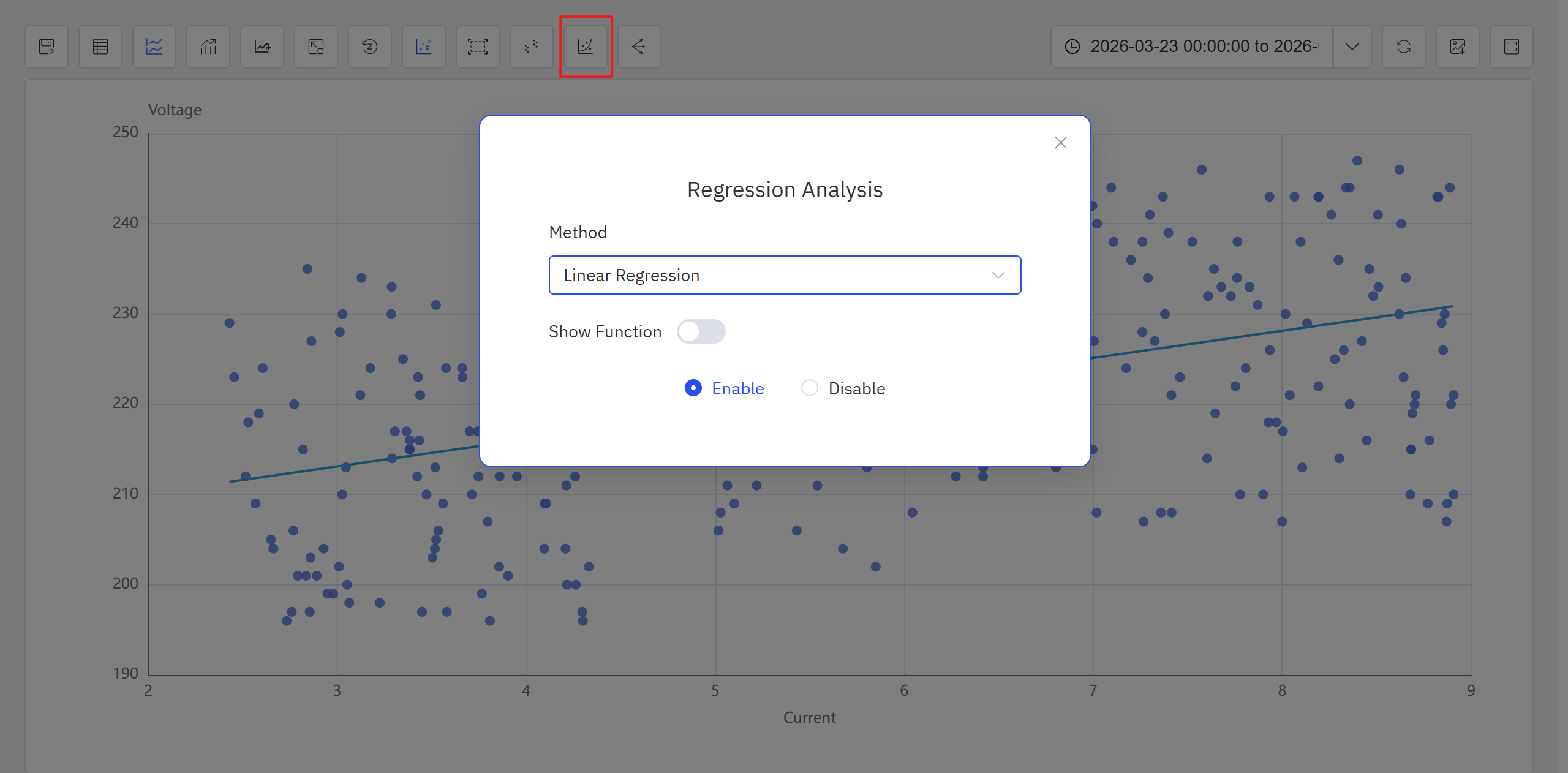

Option 1: From a Scatter Chart panel, click the Regression icon in the toolbar while in view mode.
Steps:
  1. Open or create a Scatter Chart panel. Assign the independent variable to the X axis and the dependent variable to the Y axis so the panel displays the joint scatter of both attributes.
  2. In the panel's view mode, click the Regression icon in the toolbar.
  3. Select a regression type — Linear, Exponential, or Polynomial. For Polynomial, also set the degree.
  4. IDMP fits the regression curve to the current data, overlays it on the scatter chart, and displays the fitted equation.

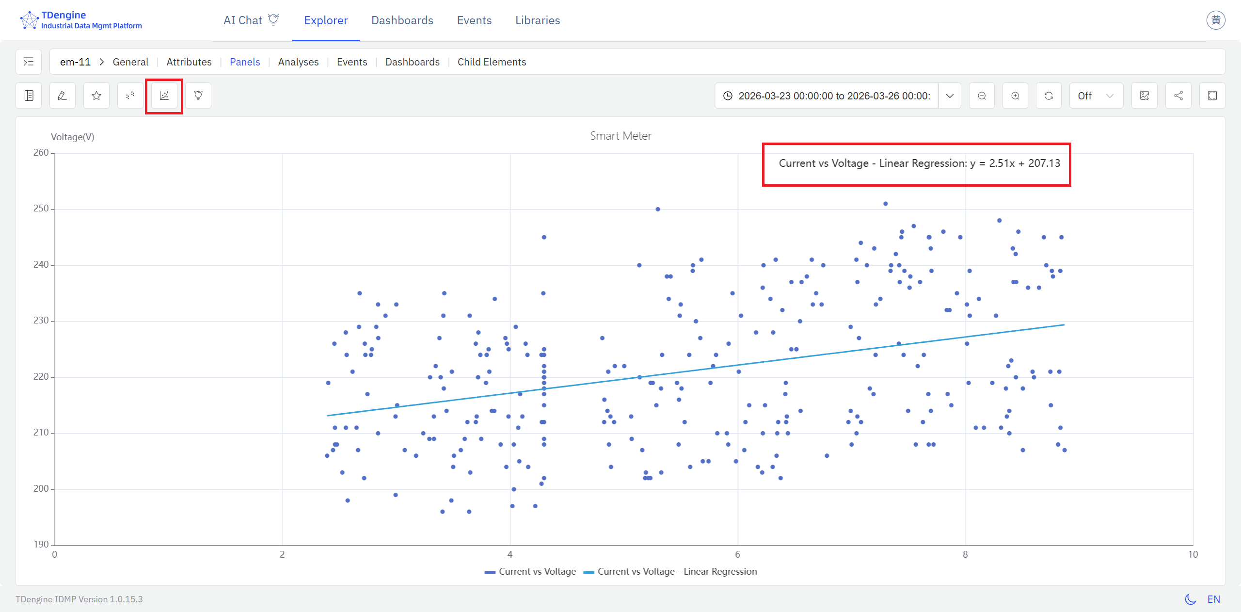

Regression curve in a Scatter Chart
The fitted curve sits on top of the raw scatter, making it straightforward to read the direction of the relationship (positive or negative), the slope, and any nonlinearity — all expressed in the physical units of the X and Y axes.

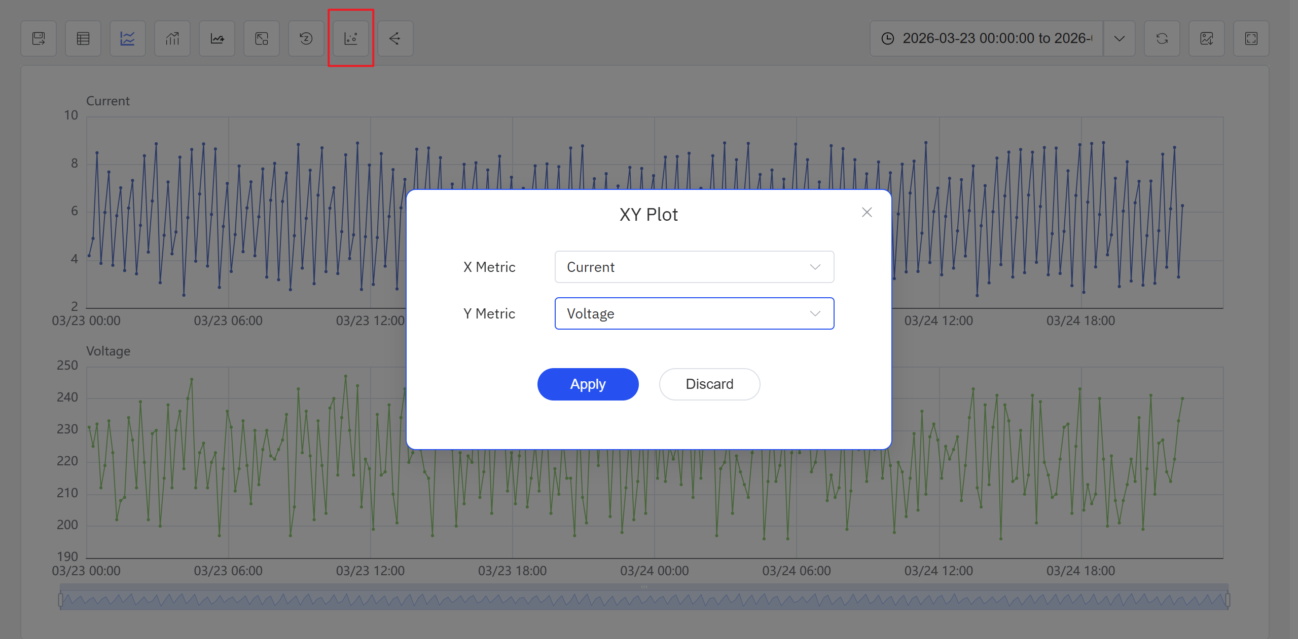

Option 2: From an Analysis Workbench panel, click the Enable XY Plot icon in the toolbar.
Steps:
  1. Open or create an Analysis Workbench panel. Click the Enable XY Plot icon in the toolbar, select the X-axis and Y-axis attributes in the popup, and click Apply. The panel switches to a scatter chart view.

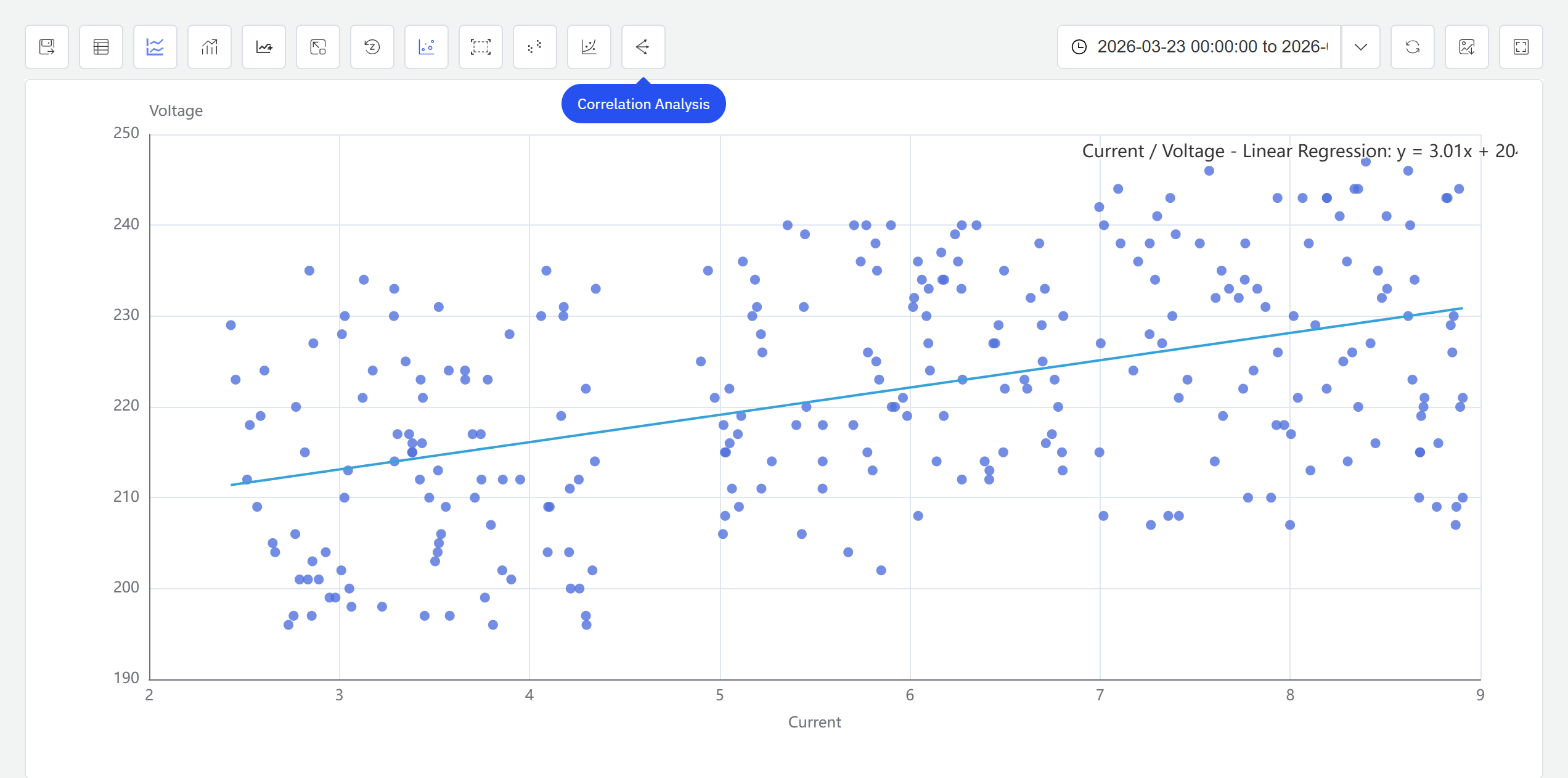

Regression from an Analysis Workbench
  1. Click the Regression icon in the toolbar and configure the regression algorithm in the popup.
Regression configuration in Analysis Workbench
  1. After confirming the configuration, the system generates the regression result and displays it on the scatter chart.
Regression result in Analysis Workbench
