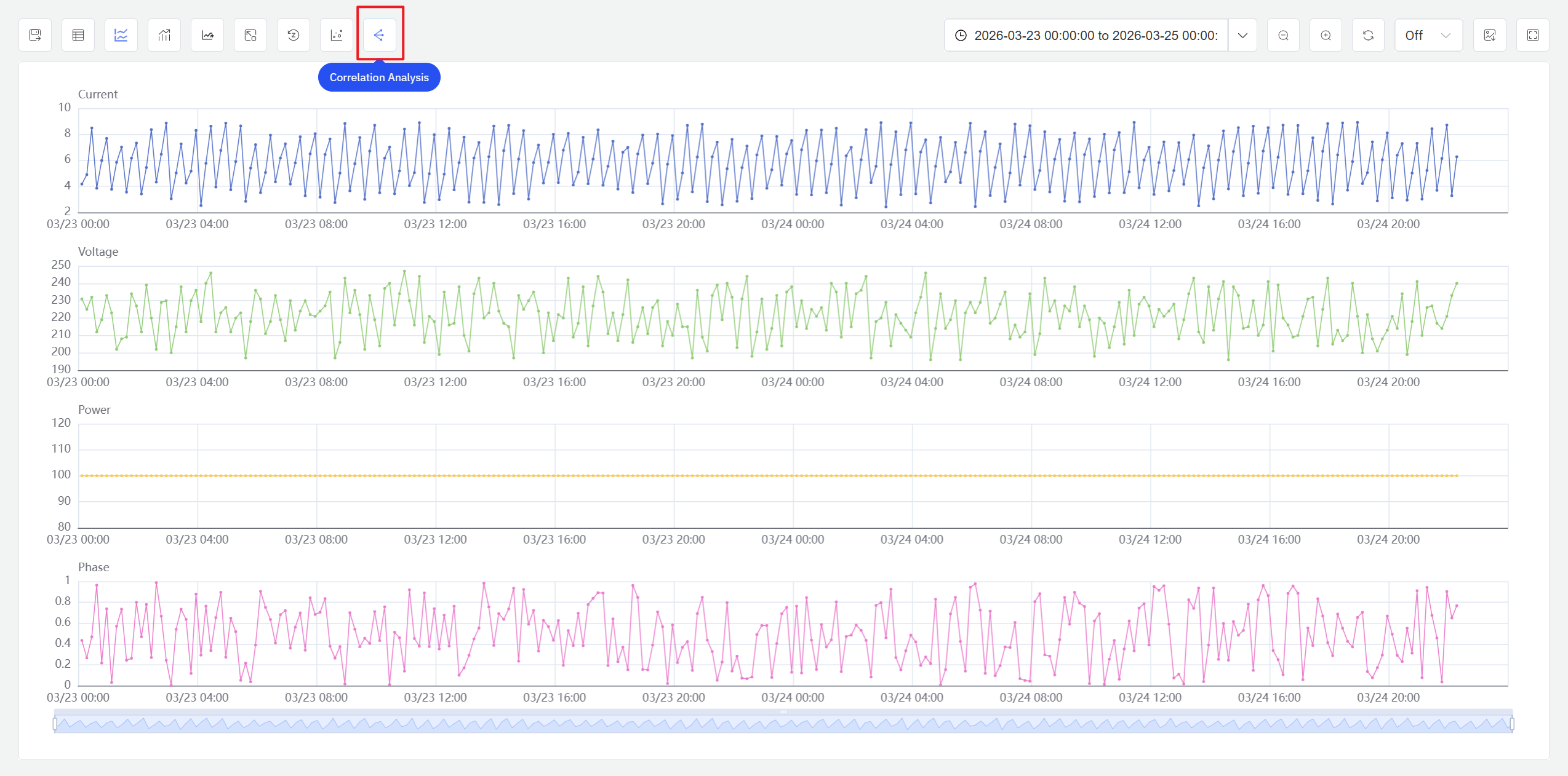

In an Analysis Workbench panel in view mode, click the Correlation Analysis icon in the toolbar to access the correlation analysis feature. Only time-series attributes that have already been added to the Analysis Workbench can participate in the analysis.
Steps:
- Open or create an Analysis Workbench panel and add the time-series attributes you want to analyze (at least two).
- In the panel's view mode, click the Correlation Analysis icon in the toolbar. The system displays the correlation analysis configuration dialog.

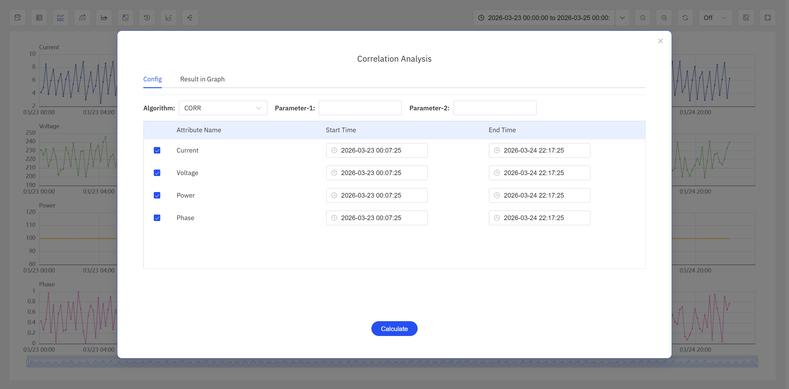

- In the configuration dialog, select the attributes to analyze, configure the analysis parameters (described below), and click the Calculate button.
- The system performs pairwise correlation analysis on the selected attributes, and the results are displayed in the Result in Graph tab.
Configuration Parameters
The configuration dialog contains the following settings:
| Parameter | Description |
| Correlation Algorithm | Select one of the three algorithms: CORR, DTW, or TLCC |
| Algorithm Parameters | CORR requires no additional parameters; DTW allows configuring the neighborhood radius (Radius), default 1; TLCC allows configuring the lag window start/end steps (Lag Start / Lag End), default 0 |
| Attribute List | Displays all attributes currently added to the Analysis Workbench; users can select which attributes to include in the analysis |
| Time Range | Start time and end time; defaults to the current chart's time range, adjustable by the user |

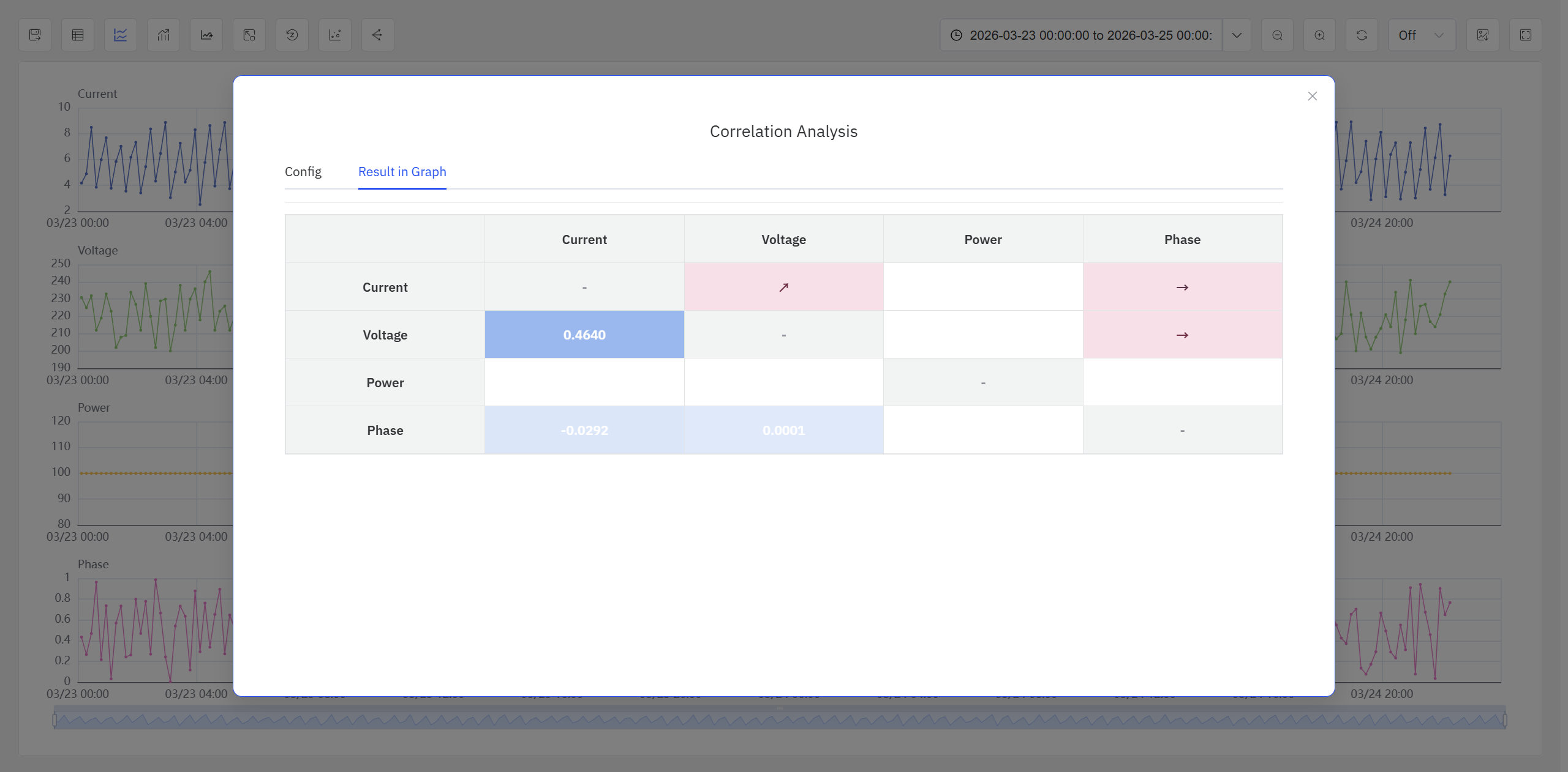

Result Display
After the calculation completes, IDMP displays the correlation analysis results for all attribute pairs as a matrix heatmap in the Result in Graph tab:
- Blue areas show the correlation coefficient values; stronger correlations appear in deeper shades
- Pink areas show the sign (direction) of the correlation coefficient, with arrow direction indicating positive or negative correlation
If a correlation analysis has already been performed, clicking the Correlation Analysis icon again displays the previous results. Users can switch to the configuration tab to adjust parameters and recalculate.
